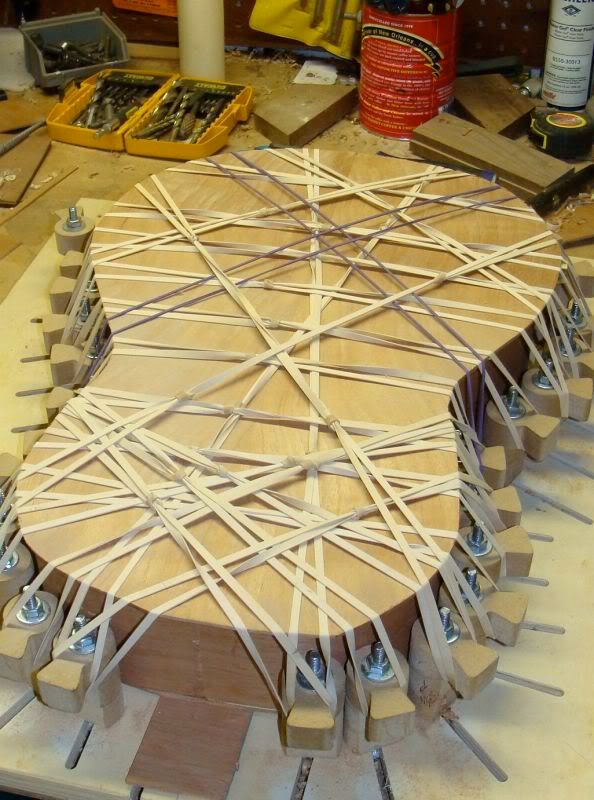

Remembered to snap picture while gluing the top on one of my dreads.
Could have used two more clamps, but it came out fine. :p
