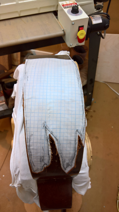

Bit by bit I am making progress. I closed the cracks on the top and back and installed cleats to keep them closed. When looking at the pictures keep in mind that I want to maintain the history of the smashed guitar. I hope to cleanly install the veneer, but the old and the new wood will be obvious, maybe even outlined with black fiber purfling.
I made an insert that included a tongue to reinforced the intact but cracked area in the sides and kerfed linings to replace the missing linings and assure a good glue joint to the top and back. I was going to use a 1 mm cross grain strip, but could not find one long enough. Instead I thinned an orphaned side to 1 mm, bent it to shape, installed the kerfed linings than fitted and glued it into the guitar. It is recessed in about 1.5-2.0 mm to allow me to inlay a mahogany veneer.

I made a cardboard template for the insert.
I bent the insert to the correct shape. It took a bit to get it to fit in the guitar. Once fitted I installed the linings and so reinforcement strips.

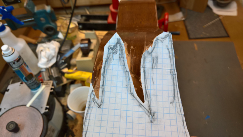

The neck step is to make the veneer. I traced the shape onto some paper. I bend the side veneer to the correct shape. THen I had a nutty idea to put the template on the inside as it would be easier to cut out the shape. I say nutty because I did not flip the template so cut out a mirror image of what I wanted.
I took the veneer back to the bender and reversed the bend. I will redo the veneer though as it is not as smooth of a bend as I want. That is why I stopped tonight.

After making an inside out patch and rebending it, I decided to start fresh. I still had the other half of the orphaned side I was using and it only take a few minutes to bend into shape. I did apply a few things I learned on the first attempt. Like before I traced out the outline rubbing on the outline with a pencil. THis time I cut it out the pattern and spend a bit of time getting it closer fitting it to the guitar. When ready I taped the pattern to the side of the side and cut close with a band saw.
It did take a combination of a plane for the top and back edges, chalk, chisels, files and sanding sticks to fit the inlay
