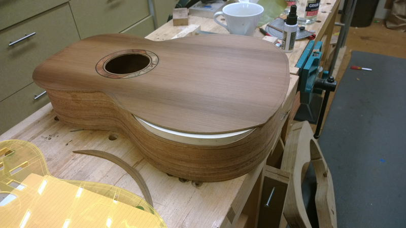

I am starting a Western Red Cedar and Koa Martin sized 00. This guitar is for me so there is no stress and the option to take risks. Fort this project I will do my first cutaway and install an arm bevel using Kent Everett's method of building it in from the start. The guitar will also have a sound hole. The other thing I will be doing through this build is to measure and document the characteristics of the tone wood and using the techniques in the Trevor Gore with Gerard Gilet Contemporary Acoustic Guitar Design and Build books.

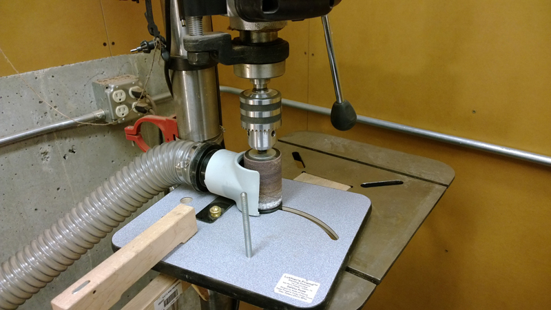

First cut a channel where you want the inside or outside purfling on the guitar, leave the router set up exactly and cut the same channel on the rosette stock. I do not cut through the rosette rather I make the rosette the same thickness as the channel is deep. I then cut a channel on the other side of the rosette channel on the guitar and again leaving the router set up the same, make a matching cut on the rosette stock.
I changed bits on the router and hogged out the center of the rosette channel. I then run the rosettes through the thickness sander back side being sanded till the rosettes drop out (learned this from Rick Davis).

Thanks! guys. The cutaway will be a Venetian, with the rounded bout. I will be using John's mold and the fox style bending machine I have from Blues Creek guitar. This will force me to change my neck heel design as I like a smooth transition from the neck to the rim.

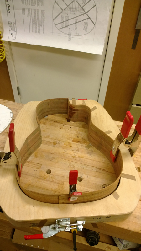

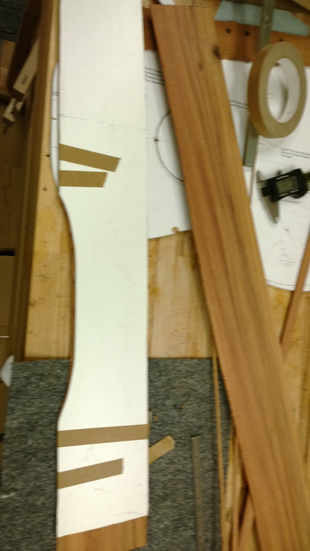

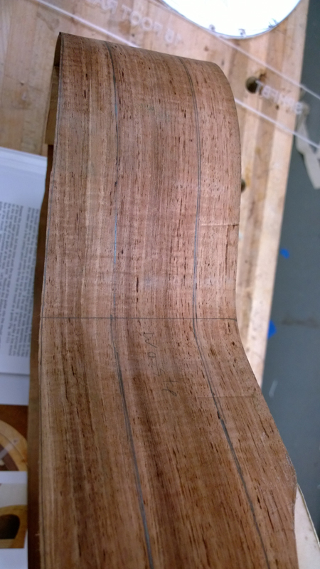

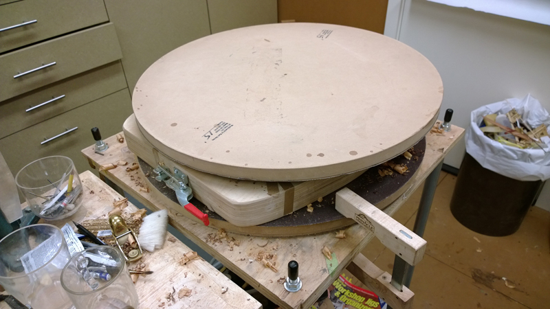

I watched a Kent Everett video The Transitional Arm Bevel “How To” Method, and he showed a method of building in a bevel while you build the guitar. The main difference in his method is to profile the rims and the top for the bevel before any assembly. His reasoning is that it is easy to get a smooth curve for the purflings while the pieces are free. The method he showed was to bend the base side and sand the bevel into it before gluing the rims to the blocks. He suggested in the video that it would be possible to profile the side before it was bent. That is the route I took. Also I watched him free sand the bevel profile on a belt sander. Not for me, I added the bevel profile to my side template and used the template to help me get a clean bevel using my Luthiers Friend.

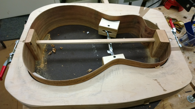

Bending the tight curves for the cutaway was scary. I thin to 2.2 mm (.86”), but I probably will take the cutaway section on my next guitar down to 1.8 mm (.7”) . On the inside bend I had some fibers pull loose. They were easy to glue back, and actually nearly sanded away. Not very deep. But this is a no pressure guitar that I am using to learn these thinks so all is good. I get to keep moving forward. First lesson learned.

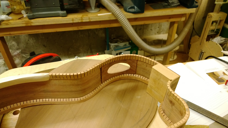

Also with the cut away I really needed to lock in the width of the neck at the 12th fret and make the heel block the correct size such that I can have a smooth line from the neck into the cutaway. I leaving out my normal pictures of gluing on the blocks as this post is going to be loaded with photos.

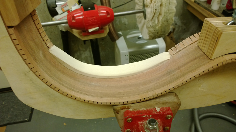

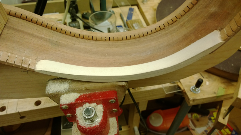

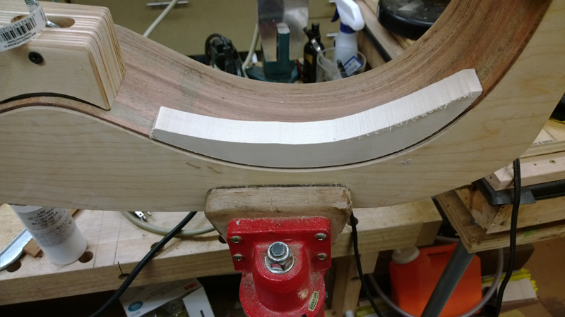

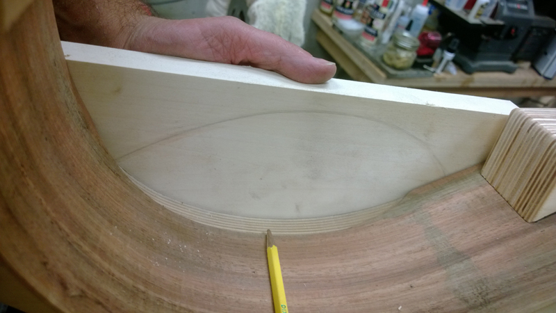

I am going to use some basswood to support the bevel. I used a half pencil to get the gluing surface marked and just roughed out the inside. I kept the inside edge square to make it easy to clamp to the rims. I glued it before profiling the rims as it needs to be radiused.

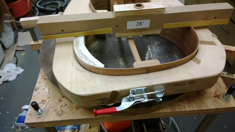

From the Gore\Gilet books, before finalizing the profiles for the top and back draw two reference lines indexed from the flat top. I set the mold from the top 25mm all around the guitar and use the top of the mode as a guide to draw my first reference line. I set the mold from the top 15mm but draw a line from the back side of the mold to make my second reference line. This allows me to always have a square reference even after I have radiused the top and the back. While profiling the rims I use the reference lines to make sure I am not making a side to side wedge while sanding.
I use a 28’ radius to profile my tops. I use my guide lines to make sure I take the rims down evenly. As the side without the bevel sands a lot faster than with I used my 28’ foot Kenneth Michael radius block to work the bevel down. Although not shown in the picture I put down protection on the treble side of the rim to keep from over sanding while working the bevel.

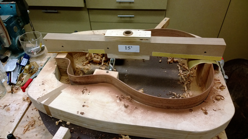

I used my 15’ block to take the back heel and tail blocks down to the correct height and the 15’ foot radius dish to quickly finish the rims.
I glue the kerfed linings on just proud of the rims, and profile them using the two radius dishes.

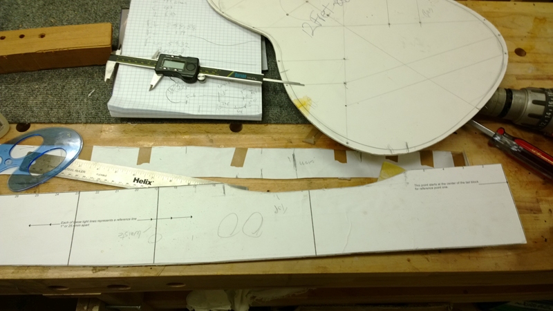

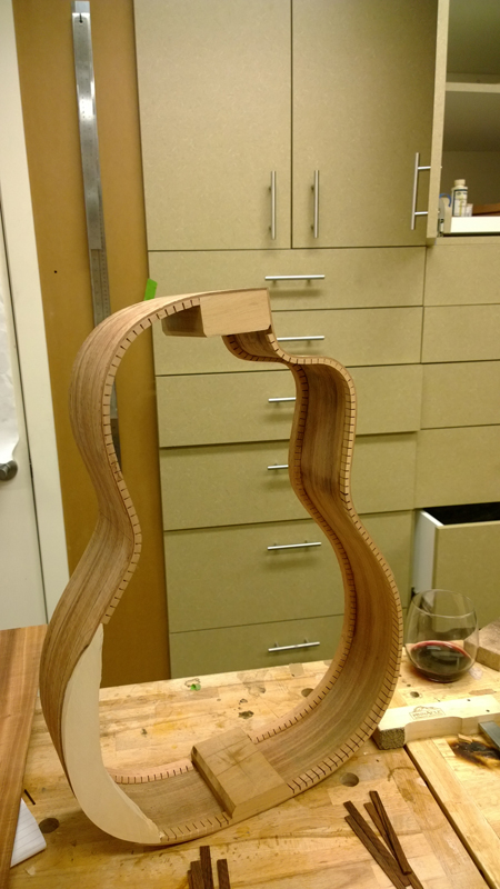

Back to the bevel. I used an 0 sized guitar template as a guide to mark the top bevel profile and a bandsaw to cut it out. Note the small cutoff on the left side. I will save that cut off to use later in the process when I am gluing on the top purfling.

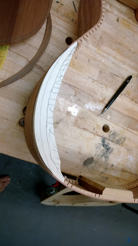

I marked the profile on my bevel support and then drew a second line about ¼ inch out that will be the support for the top.

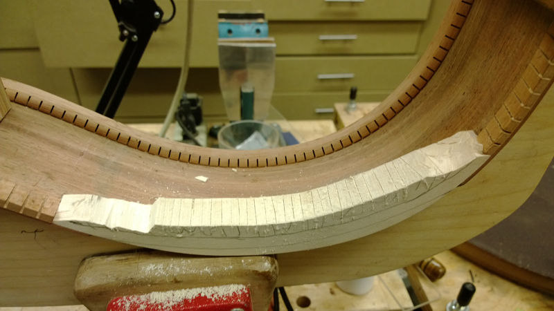

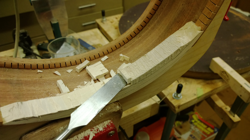

By hook or by crook I sawed, chiseled and sanded the inside of the bevel support to reduce its weight and bulk.
I have a little more to finish the rims but then on to the top and the back.

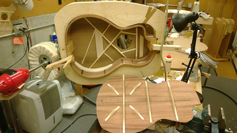

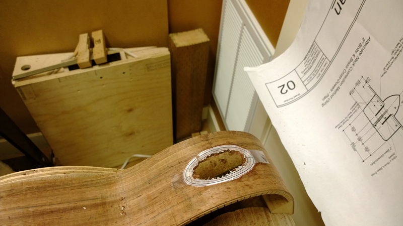

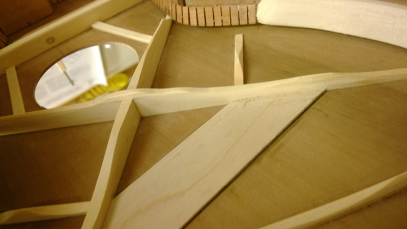

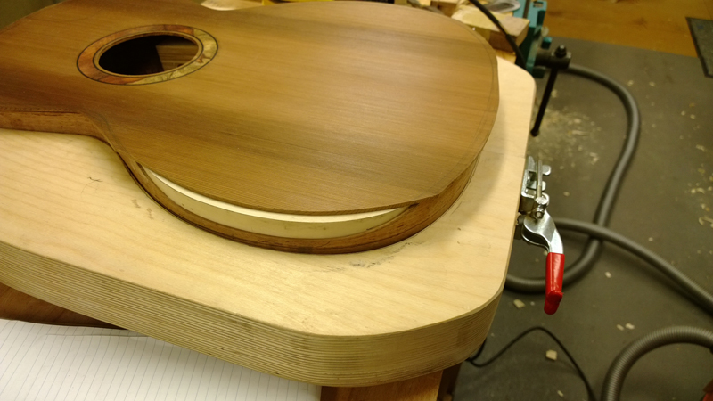

Little by little I am making progress, on this guitar. To get in practice for my retirement I been taking a bunch of saved up vacation time and have been traveling. I am about ready to close the box on this guitar. I am throwing caution to the wind on this instrument. Although this is a 00 with the arm bevel the top is closer to the size of an 0 guitar so I braced it more like an 0 with a single tone bar. Also following the Gore\Gilet Contemporary Guitar design I am trying an active back. Once the guitar is together I may need to tune the back so that it is not in conflict with the top. The back is Hawaiian Koa. With its thickness and the bracing it is a very lively back with a good tap tone and feel. I also routed in an oval sound port. Basically the works: Arm bevel, Sound Port, cutaway, active back ... We shall see how it turns out. This one is for me so I can play with no stress.

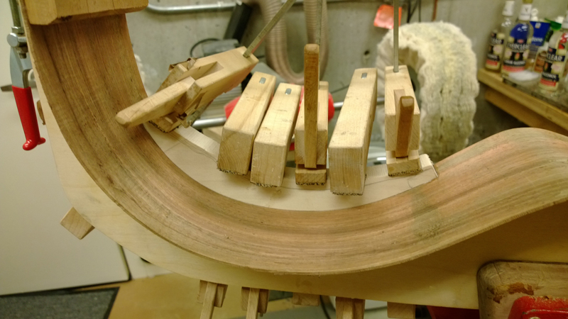

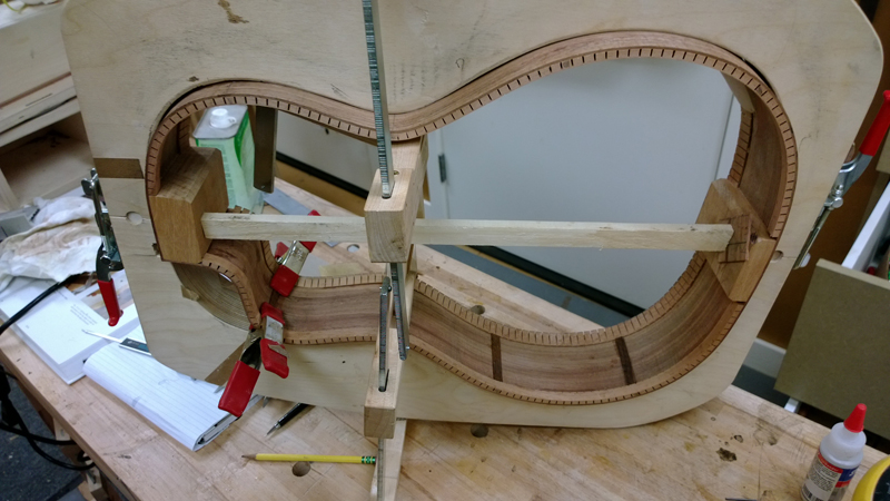

From my 2nd guitar I had a bunch of BRW strips perfect for the side supports.
My first really tight joint at the correct angle!
