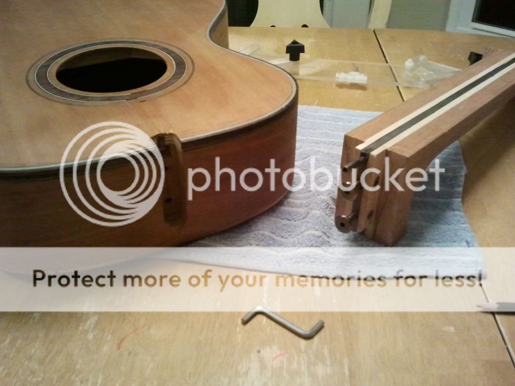

Thanks! I'm not sure I follow though. I drilled the holes for the inserts before I cut the tenon and have tightened the bolts down several times. Now I intend to carve out into the cheeks on either side of the tenon so that I have less to sand away when fitting the neck.
Edit: here's a picture of the heel after being freshly cut by an extremely dull bandsaw blade. The inserts had already been drilled and I even took them out and ground their ends flush so that they would fit inside the mortise.

I really like the guitar so far. Is that cedar?

Your pictures are pretty good! I have carved one neck so far, and it turned out fine, but your process is well thought out. I look forward to any more posts you come up with.

DJ.Dixon wrote:I really like the guitar so far. Is that cedar?
No, it's some species of mahogany that I bought at the local Rockler Hardware. I'm not sure if it's African or south American though. It has a pink shade to it when freshly cut but once it oxidizes it matches the back and sides. The center laminates are maple and walnut.
