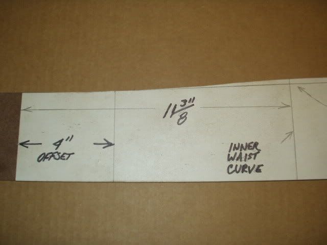

We always bend sides after profile. As a matter of fact the inner most point of the waist curve is a critical registration mark for placement in our bending machines --- and subsequent alignment in the mold. Ever since Ken Casper came up with the idea this is how we make our side profile templates -- perfect every time!
http://www.kennethmichaelguitars.com/si ... lates.html

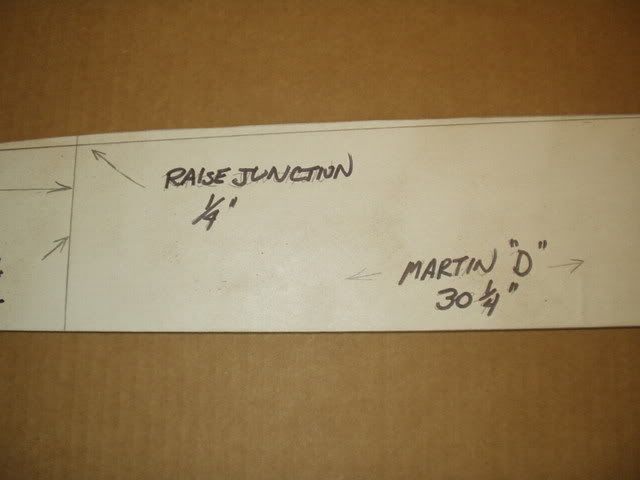

This is pretty close --- height at neck block 3-15/16" minus top and back thickness height at tail block 4-7/8" minus top and back thickness enjoy!
Re: Bend before or after profile?
I have not tried this, but run a string along the top profile in the plan mark the waist on the string, plus a few of other point taking height measurements on the side guitar view for each of the corresponding points on the string. Straighten the string and transfer the measurements and the waist location to the side profile. You can even do this on a guitar you are copying.hummingbird wrote:Thanks guys So far your all saying what I thought in the first place. It makes sense I guess. But my Martin herringbone plan doesn't have a waist point on the profile and I can't think of an accurate way to extract it from the side or top profile. I cut out a piece of paper the shape of the profile and wrapped it along the top profile on the plan and marked the waist that way but I'm just afraid it's not accurate enough. Some plans don't even have a side profile. Is there a way to get it somehow from the rest of the plan?

Thanks Ken and John. That is very helpful. Ken, what do you mean by "offset". Is that extra length to make up for errors. I would assume a little extra length is advisable.
