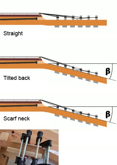

The Fender volute looks strange on a 3+3 headstock. The PRS Silver Sky (the John Mayer design) doesn't have this, apparently to give him more room in first position. If you use the volute for reference, I can see why you might want it, but it still looks odd. Of course, if anyone is looking at the back of your headstock while you play, you're doing something wrong.

The volute is the sculpted line where the end of the neck turns into the beginning of the headstock, as far as your fretting thumb can tell. A lot of people use it as a landmark for finding first position. The Fender part is just noting that they have a particular way of doing it that hasn't changed all that much in the last 65 or 70 years.Danl8 wrote:Just being an average ignoramus, what is a Fender volute?
The reason it comes across odd here is not just that it's a 3+3 headstock, but that it's an angled headstock. It's tipped back compared to the neck, which is normal for practically all acoustic guitars and some electrics (Gibson for example). However, Fender notably does not use an angled headstock, they use one that is parallel to the plane of the fingerboard. This has a dramatic effect on their choice of volute, and it means that trying to replicate their choice with an angled headstock will look a bit odd as it does here. It also means they have to use tuning machines of differing length, and/or string trees, but that's not particularly relevant to how it feels in the hands.
Different types of headstock.
