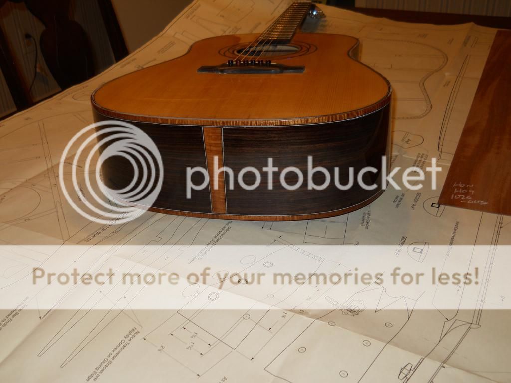

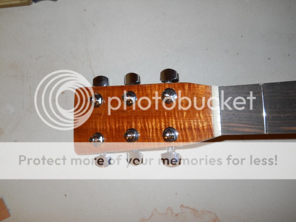

I had been so happy after having sanded the guitar so level, but when I put on the two liquid finish products, I was not happy at all. I thought I'd done it up right. The back and sides did not show good reflections. My face, when I looked at it thru the back, was blurry. Lights were blurry. I got extremely depressed.
Also, I was seeing a lot of scratches, and not sure where they came from. So, I went back to 600 grit, worked up thru 2000, then micromeshed 4000 and 6000. I went to the automotive store and bought a random orbital buffer. Then I put the polishing compounds on and WOW! what a difference that made. Now my face (not that any of you would want to see it necessarily) looks very distinct. Lots of detail. Lights reflected thru nicely as did windows and other things. Very much happier.
Here are 3 pics of the body, and one of the headstock.
I'll try and put things together this weekend and string it up.
Thanks for looking,
