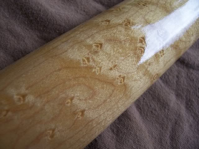

I've refinished over 200 electric necks for folks, somewhere around 80 rosewood boards, in the last 2 year and I've had no returns using Tru-oil.
Tru-Oil
Wipe it down with naphtha, apply ULTRA THIN coat with new $ store coffee filter making sure there's no excess along frets and on edges of board, no drips etc... allow to dry, wipe on another(New filter) and so on..I do 3 per day and allow to dry overnight...then smooth out with 3M 0000 imitation steel wool begining of each day.(No steel particles to deal with in the finish or anywhere else)...do 3 more and so on...for 3 days..
Your looking at 9 ultra thin coats (3 days) cured a full week and buffed with denim, no sanding of any kind. They can be any stage of gloss you wish, from satin or no gloss to high shine.
Extremely durable. My Son has been playing one for an average of 40 hours a week on the road and in and out of studio for three years and it is only now showing signs of needing a touch up.
Which is very simple with Tru-oil.
I do apply a coat of Renaissance Wax (Not any more Wax than Tru-oil is oil). This is how I do it...it works for me.
