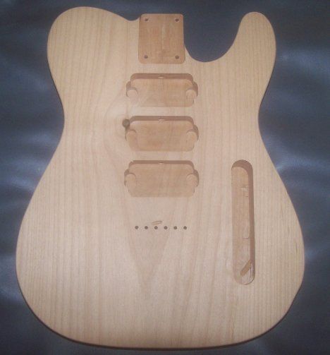

I am building an electric strat style partscaster using a black walnut over mahogany body.
I am planning to finish it with tung oil, thinned with naptha 50/50 and decreasing the thinner as I go.
1. Does this type of finish require any sanding, or do I just take care to wipe excess off and let dry well between coats? Body is already sanded to 220 grit.
2. Would I use the same process for the neck?
3. If I plan to put a decal on the headstock and clearcoat it, should I leave it 'un-oiled'?
Thanks for the help
I am also attaching the neck with inserts instead of just bolts.
Thanks for the help
