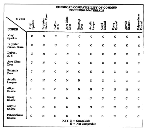

As an Industrial Engineer by trade I would submit that epoxy is difficult to use as a pore filler -- because pore filling was not the design intent. That said, you have to wonder why the epoxy manufacturers cannot give out or does not have an on top "over" and "under" chemical compatibility chart. As an example here’s a chart that includes Zpoxy (poly finishing resin) – the design intent for this product is for use by modelers to bond fiberglass to balsa wood. Interestingly the only thing that the Zpoxy goes on top of -- is itself?
Re: Epoxy fillers
That squares with the limited research that I did. You need to put the zpoxy on the wood. It did well on the under!kencierp wrote:... Interestingly the only thing that the Zpoxy goes on top of -- is itself?
