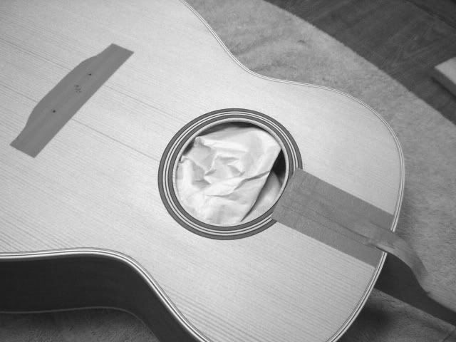

Finally getting set up to start spraying on my finish this weekend and I realized I've made no provision for holding the guitar body while doing it! Any suggestions?
I'm thinking somehow bolting a piece of scrap into the dovetail slot so I have a handle to hold and turn the body and something to hang it by to dry. There is a threaded insert already installed in the neck, I guess I'd have to get one like it and install it in the body so I can attach a bolt? Never done such a thing before - are they epoxied in?

It must be exciting to get to this stage! I can't wait to get there. Well, actually I can wait, just a figure of speech, you know! Looking good!
