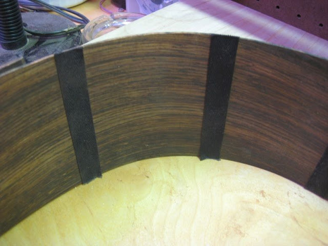

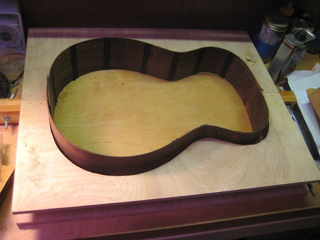

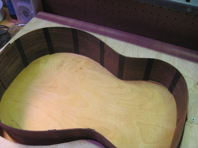

gee, it seems to me that those looks worse. anyhow, here also is an OM mold I made yesterday, and the sides trimmed to fit into the mold. the second guitar was tons better than the first. and the third was better than the second. and now this is my fourth. i'm so excited...
here's the ribbon i'm using for the sides. it has some cotton in it and a cool texture. it isn't 100% polyester like the ribbon that Wayne Henderson uses.

Nice rosette and mold! Having just completed my first rosette as well I can share in the euphoria. Your mold looks very similar to the one I've made (but haven't used quite yet.) What's the depth on yours? What did you use for spacers?
enalnitram
Re: My first rosette attempt
Post by enalnitram »
