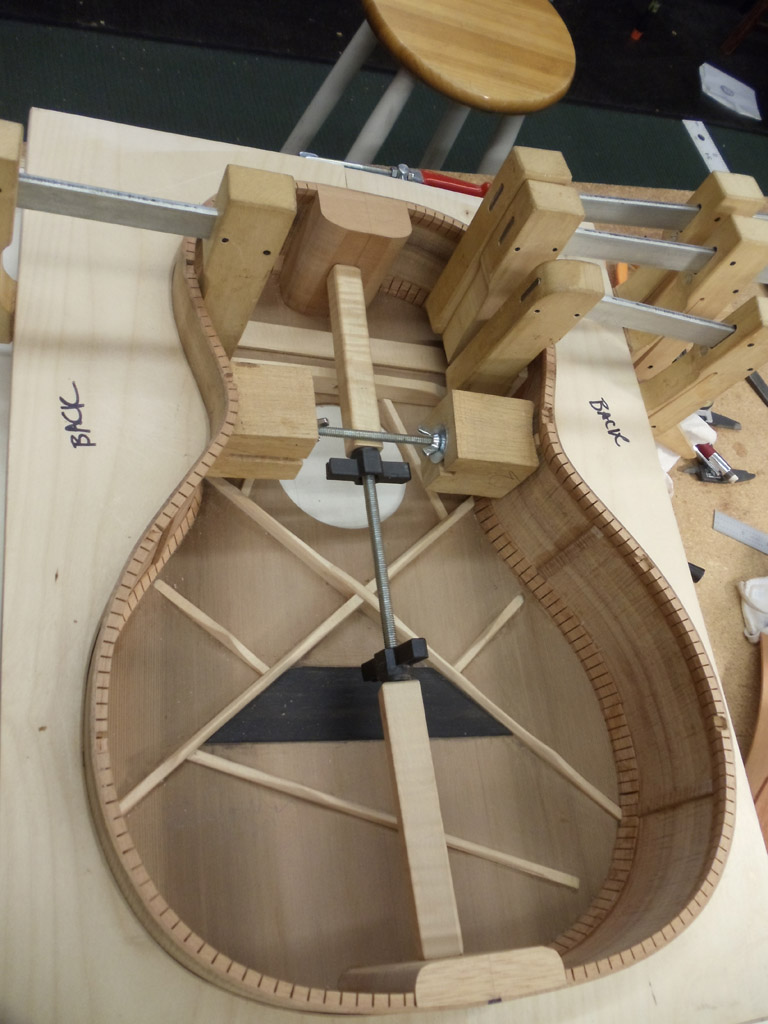

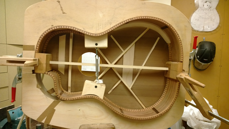

Re: Tone Bars
I found the single tone bar allows the guitar to have a bit more bass response. Removing one tone bar allowed for a lighter top. On the one tone bar pattern I start the tone bar as the end of the bridge plate but angle it to cover more of the lower bout than the top bar of a two tone bar pattern.
I measured the resonance of a two tone bare top and a one tone bare top and they were nearly identical. The top resonance follows the long-wise stiffness and mass. I did not weigh the two tops so I am not sure how I they ended up the same.
My normal 0 pattern
Same on a 00

Re: Tone Bars
Thanks John. That clarifies it a lot. I thought it would allow more bass response, but I wanted to make sure. The photos help loads.johnnparchem wrote:I found the single tone bar allows the guitar to have a bit more bass response. Removing one tone bar allowed for a lighter top. On the one tone bar pattern I start the tone bar as the end of the bridge plate but angle it to cover more of the lower bout than the top bar of a two tone bar pattern.
My normal 0 pattern
Same on a 00
