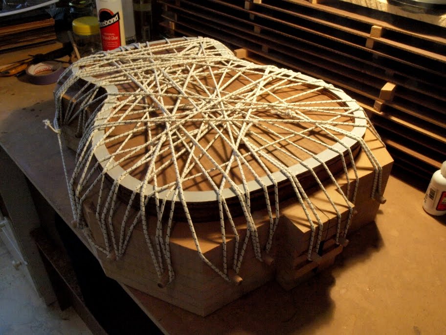

Hello.
I used an outside mold and was wondering the same thing as I didn't have spool clamps and I only had a few cam clamps. What I did was this (not my idea, saw it here on another thread...) I purchased about 30 or so 1 1/2" threaded hooks from a sewing/craft store. I screwed them into the mold body about 2 - 3 " from the inside edge of the guitar outline, I bought several sets of long, flat cotton sneaker laces, tied them together to make a very long shoe lace "rope". I glued up and set the top and bottom (one side at a time), secured the mold to the bench and I strapped down the whole top and bottom (again, one at a time) in a "criss cross" pattern. Worked out perfectly. Please, as always, go through the whole process DRY (NO GLUE) the first time as practice! It may sound like an unnecessary step but please do it. It will save you from a potential big mess. I hope this is clear enough for you to imagine... I will look for a picture. Good luck!
This is the thread where I got the idea... I used hooks on the top surface of the mold, he used nails into the side of the mold...
viewtopic.php?f=29&t=5610&p=27008&hilit=strap+mold#p27008
Thanks to "darren"...

Post by Tom West »
http://4.bp.blogspot.com/-piWdNit2K74/T ... lamped.jpg
I do it similar to this only using large elastic bands.
Tom

Re: Building with guitar mold
Post by JLT »
Tom West wrote:http://4.bp.blogspot.com/-piWdNit2K74/T ... lamped.jpg
Tom
I've used that system. It works well, particularly on smaller instruments like ukes and mandolins.
You can use spool clamps, though, in a way. If you put series of threaded inserts around your mold, just outside the untrimmed soundboard, you can put in a short length of all-thread into it, and use the half of the spool clamp that touches the wingnut.
