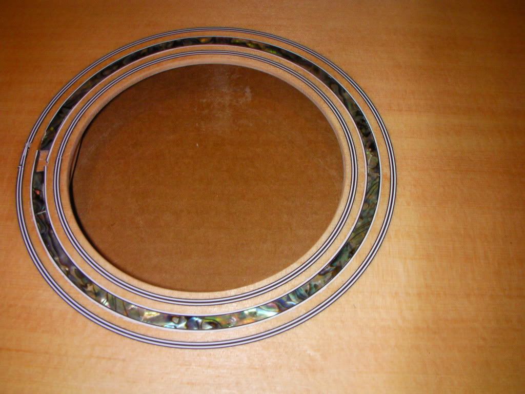

My challenge was that my kit came with the rosette rings pre-cut to the Martin standard (radius and depth). And Martin would not ship shell to Canada.
So.... I figgur'd I'd see what I could do with the method from the "Guitarmaking" book.

Here's the outcome:
I had a double coat of shellac in my grooves and used CA.
