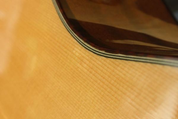

Yes, Once the CA is in there, only sanding can help you. If there is not enough thickness to work on, you have to live with these spots:
Here I fixed a bit loose binding in the waist. After finishing a visable spot remained. So be careful on the CA-use.
