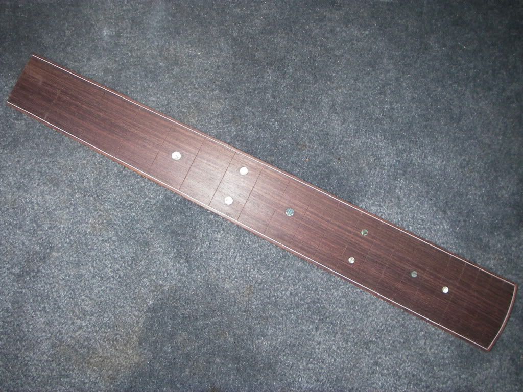

Thanks for all of the input on this.
Here is how it is looking... I'll be fretting this weekend... (now I understand the different meanings of that word!)
We'll see how it goes with the stopped slots. I have notched the frets, and will double check to make sure I have enough clearance in the slots and enough overhang.
