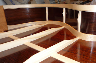

I would recommend you glue your braces first, then sand to your heart's content. I sanded the inside of my first guitar to 600 grit before I closed the box. I have never done that since. I stop at 320 now. It looks nice and smooth and well crafted at that point. I don't like the inside of the box to look sloppy, but I am not yet going to the point of putting a wash coat of shellac on the inside like Somogyi. I am certainly never going to do something like this:
That dude French Polishes the INSIDE of his guitars!! Taran Guitars is the company for anyone interested in looking at his work.
Once the braces are glued on you can do anything you want. Just make sure you leave the edge of the back and top plates a bit rough so you can glue them on too.

Tony_in_NYC wrote:I would recommend you glue your braces first, then sand to your heart's content. I sanded the inside of my first guitar to 600 grit before I closed the box. I have never done that since. I stop at 320 now. It looks nice and smooth and well crafted at that point. I don't like the inside of the box to look sloppy, but I am not yet going to the point of putting a wash coat of shellac on the inside like Somogyi. I am certainly never going to do something like this:
Man, if I owned that guitar I'd probably be in the nuthouse. I'd spend every waking moment picking specks of dust out of the inside of it :p
