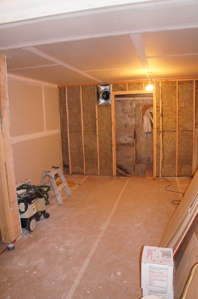

Progress is continuing. The drywall is going up, the climate control system is in place with the ducts roughed in and the electrical wiring is being strung. This first picture shows the room from the entry way. The two closets toward the back are my spray booth and a closet for the dust extraction system. The insulation is really a sound bat. All of the studs are isolated from the house with a rubber gasket to control vibrations.

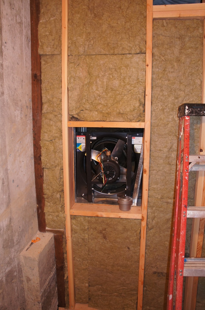

The paint booth is small 5 feet by four feet, but I do have a giant fan made For hazardous use and the electrician is going to do the wiring to a code for a paint booth. The hvac guys wanted a fan big enough that the whole shop will be at a negitive presure so that there is no chance that fumes will go to the rest of the house. It is rated for 1 ton of air movement

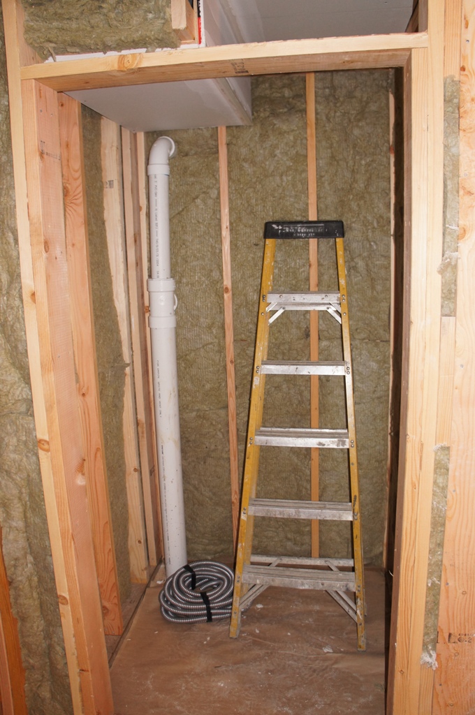

I am going to install a ClearView dust collections system so I am placing the whole unit in a ventalated closet, to keep the noise down.

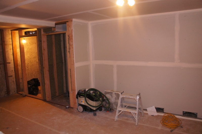

This is a look back from the far wall. I am having about 12 feet of cabinets built with lots of drawers low and shelf space higher to go where there is drywall the vacuum and the step ladder is where the cabinets go.
