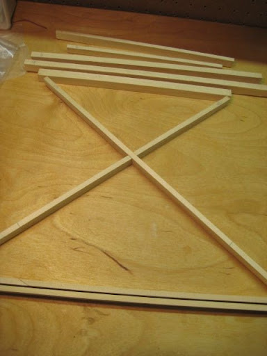

made this bracing a few weeks ago. (spruce dust messes me up the worst. should be more careful next time)

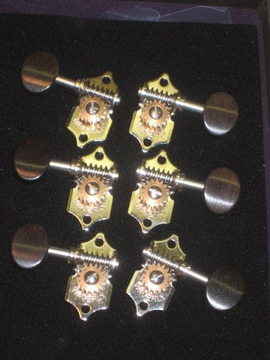

waverly tuners with ebony buttons.

Wow, looking good Martin! Love the tuners and the Braz.

That wood is so purty. And Waverlys too!!

i remember a couple of years ago on this site that I was totally intimidated by someone that had a really nice completed guitar with waverlys on it. and now here i am using them, but only because dude bought them.

my sandpapered wheel motor thing works well, it removed material from the ends of my upper transverse brace in a hurry. i'll keep going on it and do the rest of my braces next.
The angle on the X-brace on that '32 OM-18 is just about exactly 100 degrees.

Moving right along (at about a few hours per week)...
Still more work to do on that bracing.
I used a 100-yr-old piece of spruce that a friend pulled out of his house. nice and clean and very, very stiff.
