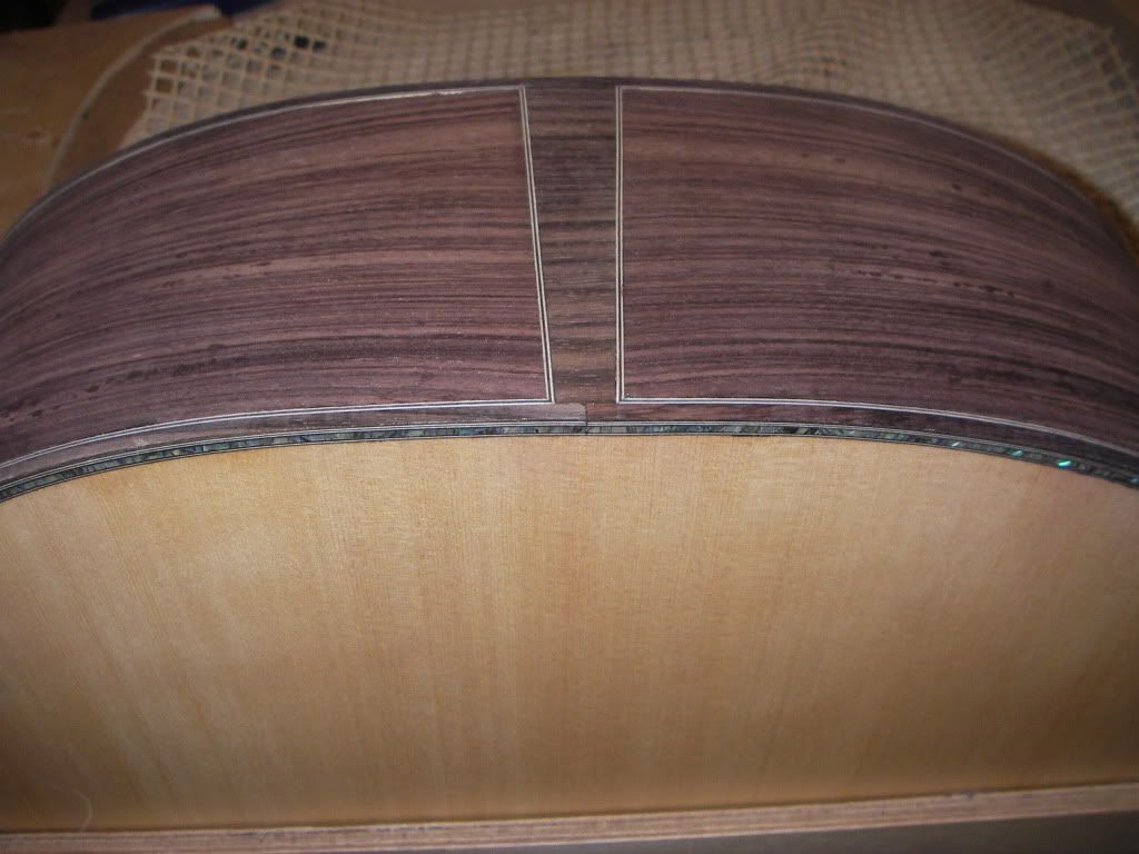

Re: Purfling - BWB and WBW - can they coexist?
If I posted ALL my bonehead moves, there wouldn't be enough room on the forum to store them.
But this one was pretty good...
Was pretty pleased with my end graft (whatever we call that piece) .... until I found that I used .040 purfling when the purfling on the binding was .060.
Duh.
We'll carve it out and try again....

Bruce, just miter that at maybe a 30 deg/60 deg angle (or something close) instead of a 45, and see.
Just test some small pieces to see what angle looks best and go with it. I don't see that much problem really.
I know it's not what you want, but I bet a good sharp angle on that would put it right in line and look good.
Or just let the line along the binding continue around.

neat idea... to make an "oblique" miter to match it up.
But I've already ordered the right size purfling. It'll only take me 15 minutes to set up the dremel to route out the channel again. I have some spare rosewood to make another piece.
It'll be OK.

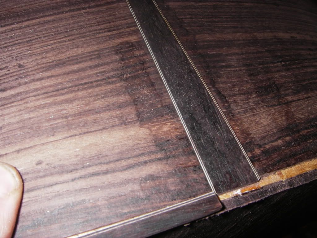

Well... after two weeks "in the penalty box" (waiting for Stew-Mac international shipping), I was able to get back to my binding.
I carved out the old graft, and re-did with the right size purfling. I made a new graft with the grain sideways... I am not sure what the convention is on that, but it makes sense that the grain should be crosswise to the graft.

PS. Thanks Ken C for the suggestion to use wbwb purfling beside the rosewood binding. It looks great.

Bruce, glad it worked for you. Looks nice! I tend to run my end graft grain vertical, but I tend to use woods with more contrast. The joy of building your own guitar is you can do it how you want!!

Nicely done!

Looks great! I too typically run the grain 90 degrees from the side grain, but mearely as another way to create a little distinction in the end graft. I suppose some argument could be made about the structural reasons for doing so....cross grain support in preventing the tail block from splitting at the end pin, maybe.
