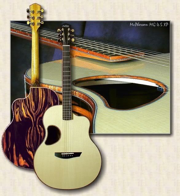

Tony --Are you confusing the dove tail conversation with the MT concept? With the MT bolt on the compression washers hold every thing in place and if they do move you just push the neck down and re-tighten. The dove tail is a different animal -- the two "V,s" have to be in perfect contact top to bottom any up ward movement means the joint failed -- so if you glue the FBX to the sound board the neck is less likely to move upward and disrupt the glue joint -- make sense? Or am I missing your point?
Re: Fretboard extension.to glue or not to glue
And yes the McPhearson image points out that this is all preference, not a universal law of guitar making.

The picture uses a floating extension not a free extension. there is a difference . The spring back from fretting is what can cause an issue . Having 2 degrees in engineering Mechanical and Industrial I think I know how to check a process for repeatability.
Having a variable that is not controlled ( fret cpmpression ) will not make a process repeatable. A design flaw may not present itself right away. These are where you have the best opportunity for learning. Stress risers that may be overlooked can often be the scourge of building .
Is there a perfect design ? I doubt it. There are many designs of floating extensions , Martin used it on the Millennium, Tom Humphrey's design and it worked but the fretboard was technically glued to the neck as the McPherson design. Archtops have been built like this since the 20's so it isn't a new design and is a proven concept.

The McPhearson image shows that they feel the neck joint is not compromised, also as mentioned, many different instruments in the "string family" even have dove tail joints and by design, the FB extensions are not secured to the sound-board.
