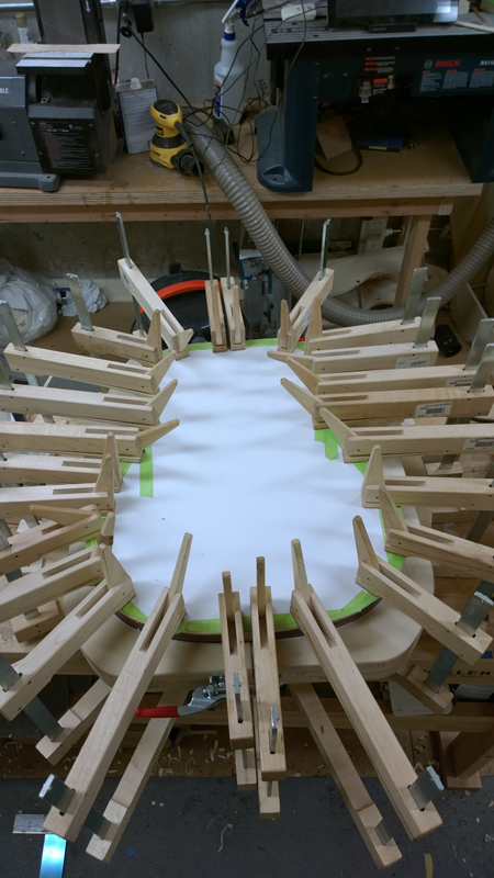

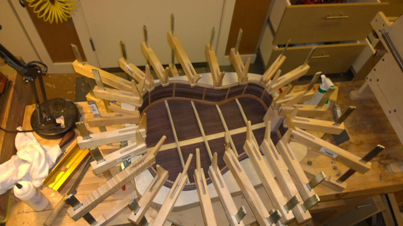

Not my idea - I make a cheap clamping caul out of 2 layers of 1/4 plywood - it is open in the middle so it does not have to bend over the dome in the back or the top. Then a clamp every couple of inches has its pressure spread out by the caul and fewer clamps are needed. I use the 8 cam clamps I have, then 2X2 or so pieces of wood with a bar clamp or a pipe clamp at either end.
Be sure to properly support the bottom of the rim with plenty of wedges to take the force of the clamps
Sorry if these are in the wrong order - the photo upload is weird and sometimes they show up backwards
Ed
Ed
