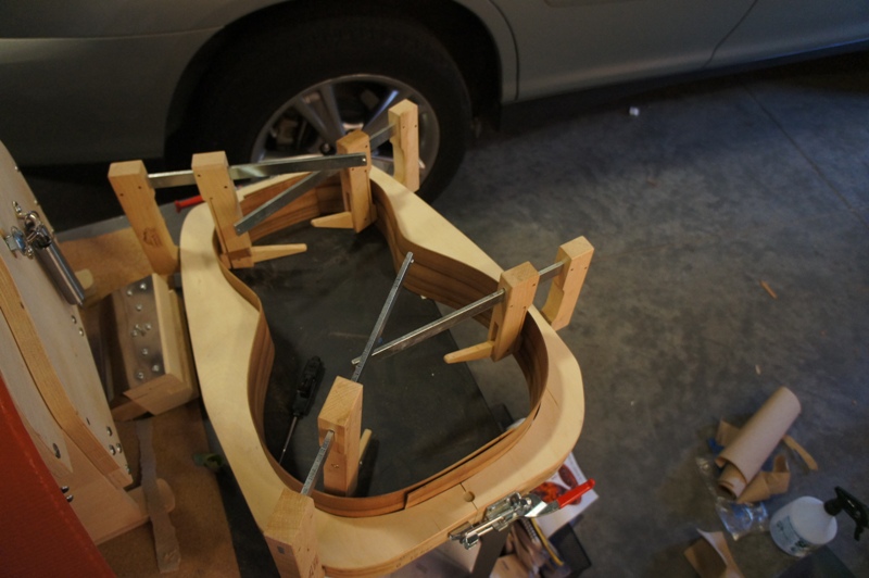

I went ahead and bent the sides with my Blues Creek guitar bender. That all went well the sides were thinned to a bit over .09" before bending.

After the last top disaster I set off to put a new rosette on the to my new top. As shown in the previous post I cut and book matched the rosette veneer out of an amboyna burl. I spent a little time laying out exactly what I wanted as opposed to winging it which is my normal style..
I went with we a slightly bigger sound hole 3 3/4 than the Antes plans I have show. I like the look at hope that it give my a bit of a deeper resonance than the 3.5" hole the plans had.
The next batch of picture show how I learned to make wood rosettes from Rick Davis (runningdog). Using the router I carefully route out the rosette only to the depth that matches the thickness of the rosette I want. (than a smudge more). Once routed I run it upside down through my drum sander until the rosette drops out. Doing it this way keep the rosette nicely centered in good wood while doing all of the routing.
With the rosette made, I carefully laid out and routed the rebate for the rosette and an inside and outside fiber purfling .020".
This time before I did anything with glue I shellaced the rebate to avoid stains.
The rosette fit so well I used thin CA to glue it down. After leveling the rosette, I applied a wash coat of shellac to protect the top until much later in the project.
