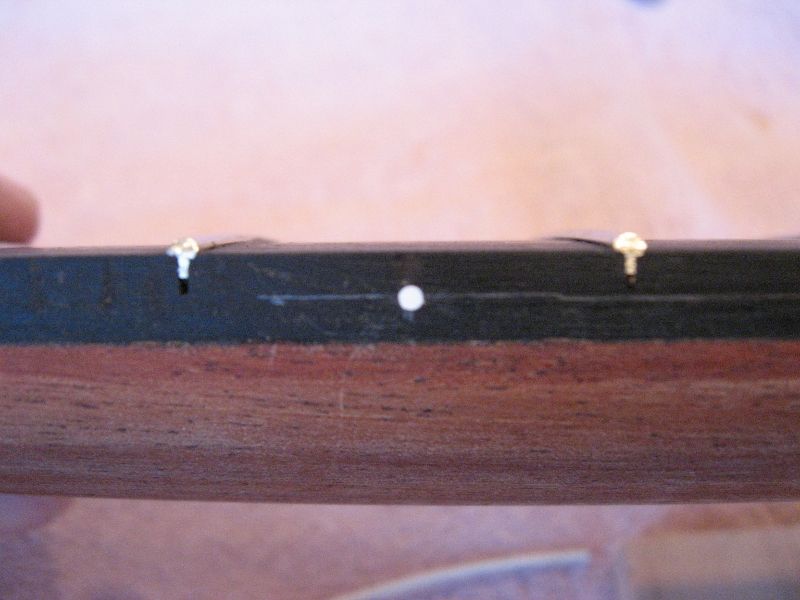

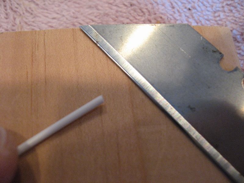

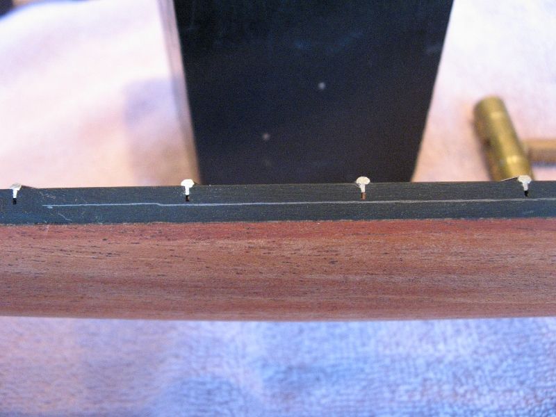

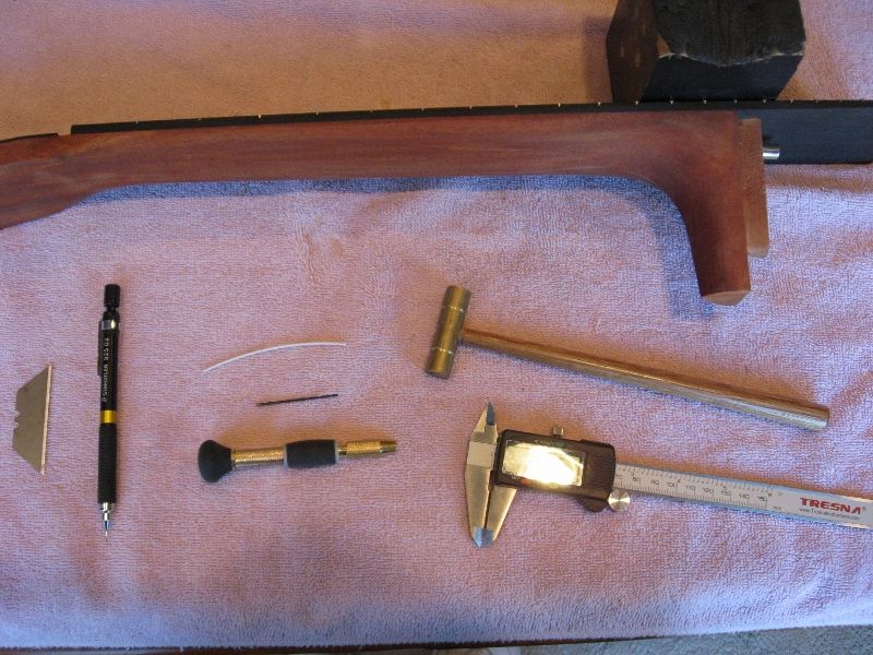

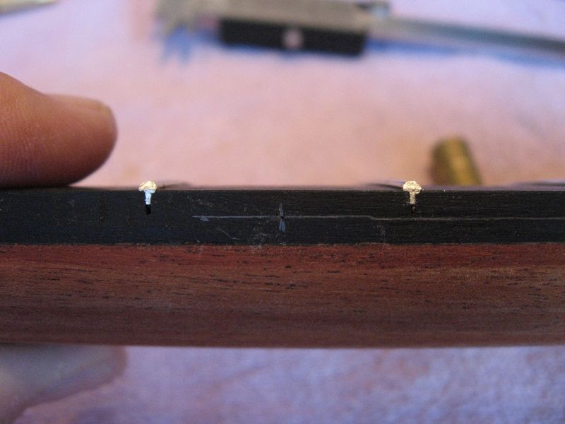

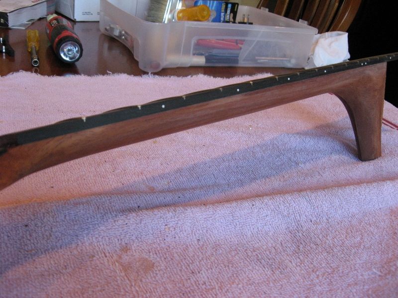

Time to inlay the side position markers on the FB. These are the supplies and tools I'll be using:
1. Razor blade for trimming and beveling the side dot material
2. .3mm pencil for location marking
3. White side dot material
4. Pin vise and #54 (.146") drill bit
5. Fretting hammer for seating the side dot material
6. Digital calipers for measuring locations

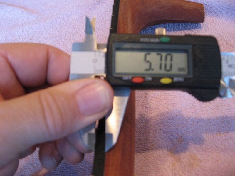

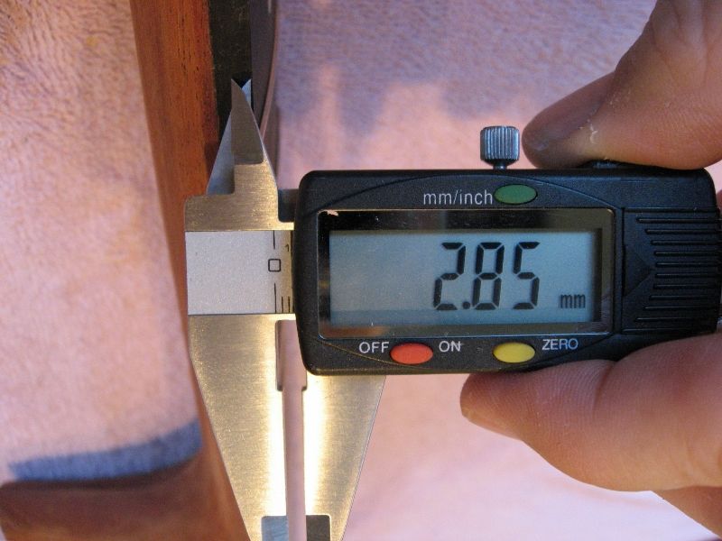

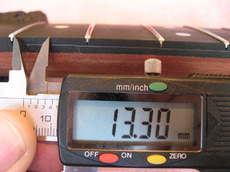

First I measure the FB thickness.
Half of that gives me my center location and I mark 2 spots of either end of the FB and draw a center line.

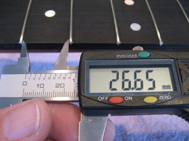

Measure the distance between frets and take half of that for the center point.

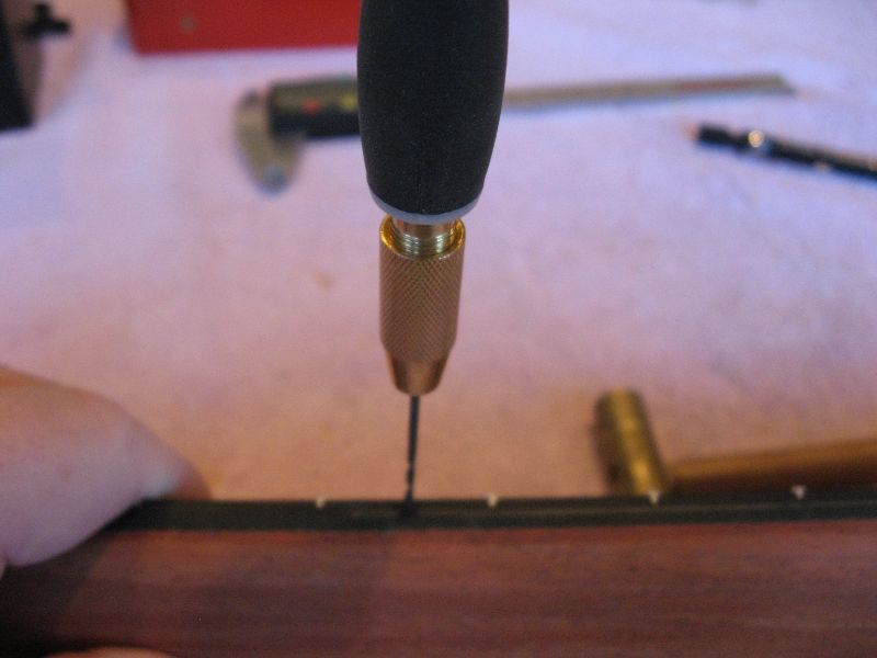

I use the point of my calipers to punch a center hole and mark it with the pencil to be sure I'm on spot.
Drill the hole.

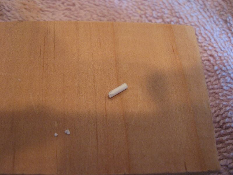

Bevel the end of the side dot material and cut off a small piece.

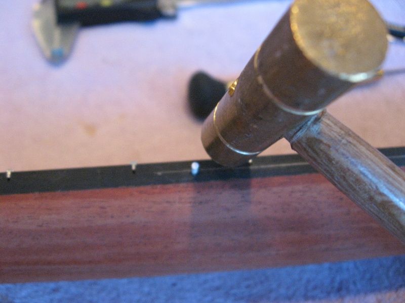

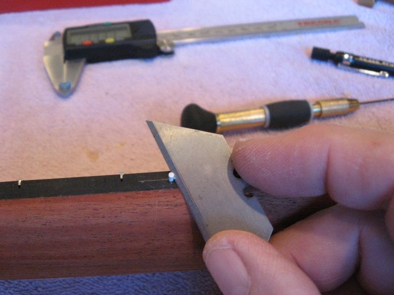

Tap the side dot material into place and then trim it off.
Here it is in position and then I do the same for the rests of the positions, all done.
