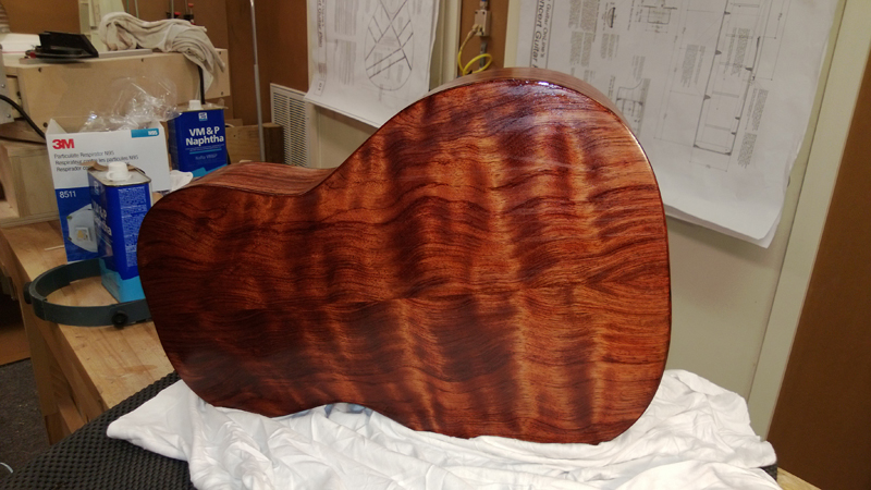

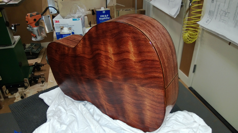

Thanks Kevin. Here one of the steps I live for; only second to the first strum. The first coat of zpoxy.

John that grain pops like crazy! What a nice looking piece of wood....

Judging by the cloth under the body you most likely already know to beware that little back rubber mat. I had one like that......left marks in the back of a body I was working on, before the finish. Had to scrape and sand pretty good to get that cross pattern out. Not very lacquer friendly either evidently. Don't even have one in the shop no more. Oh yes almost forgot, looking very sharp.

You are right about the mat I ran into it with a violin. That was a real pain as I had a sunburst pattern using some spirit varnish. I should get rid of it as well.

Ha, I have the same mat.......and had the same issues.
