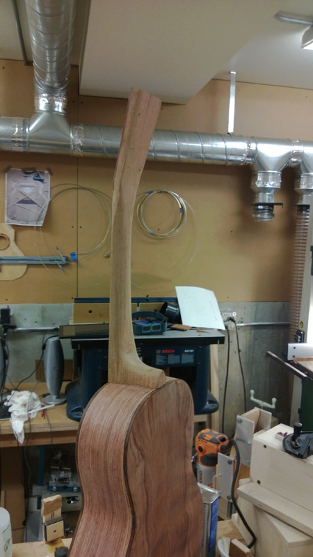

With the neck basically roughed out, I used a template to draw the end cap and on the cheeks the profile of the heel. I also redrew all of my center line to get ready for carving. There are a lot of ways to carve a neck but here is what I found works best for me.
Using only long sweeping strokes, much like one would use a knife, I start removing wood that is farthest from my guide lines on the heel, cheeks and top. The sweeping motion assures that smooth curves are being established. While following the heel and end cap lines I work to the point that I am sort of an even distance away from all of the lines. From that point I just patiently use very long sweeping stokes working one side of the heel toward my guide lines. On the top I look for the carved heel to evenly approach the center line. Doing this most of the curves come naturally as the thickness of the wood changes.
Then I turn it over and do the other side.
Here is the rough carved heel on the guitar. I will carve the neck after lunch.

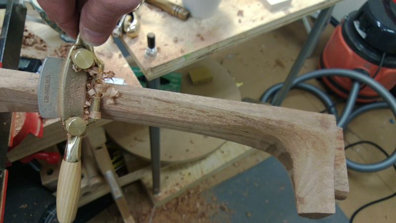

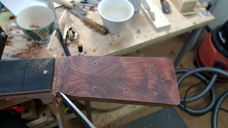

Carving a neck with my Christmas LN spokeshave is a dream come true. I worked out my neck profile for the first and 8th fret on paper, drew a tangent line and measured where to put a couple of lines on the neck to take off most of the corner. I then used the spokeshave to make a facet down the neck. If I was the patient type I would have drawn a bunch of more lines for finer facets but after the first even face on both sides I just eyeballed the rest. I used a chisel to finish off the peg board and blend it in.
The neck still needs a bit more work, but first I need to get the inlays in the fret board and glue it on.
