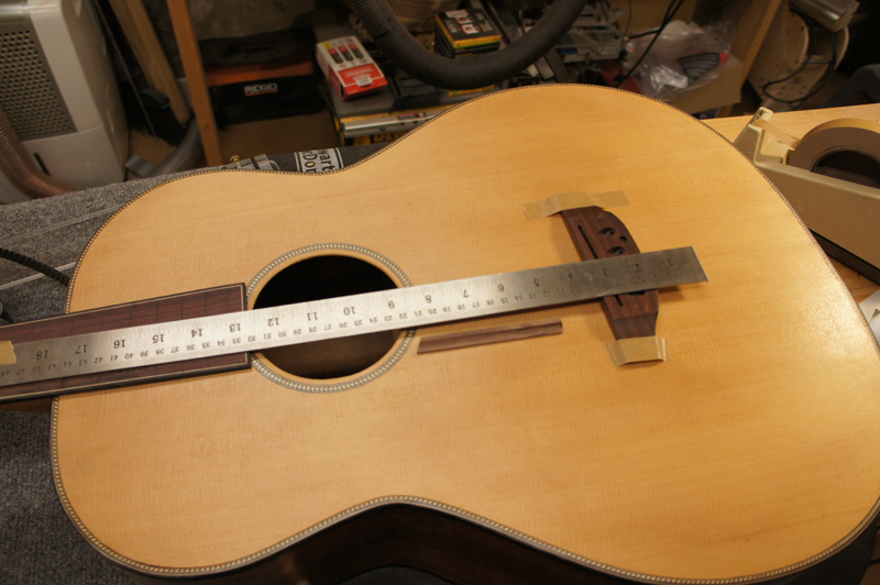

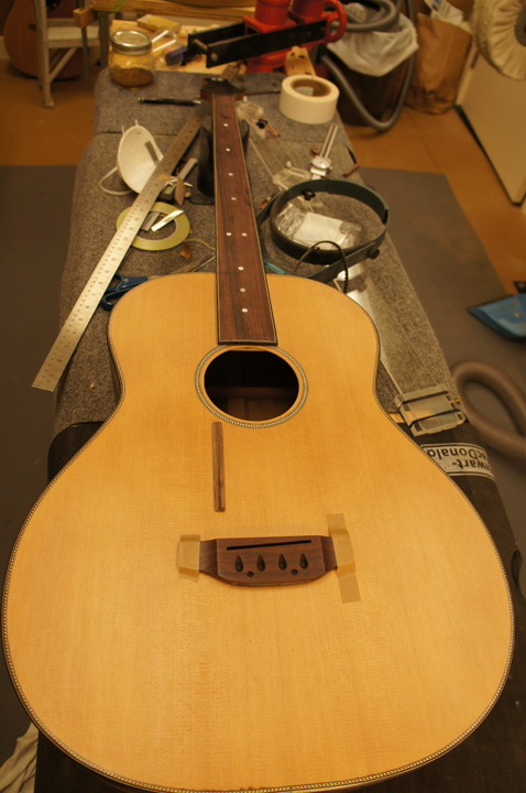

At least the top was ready to finish I have another day on the back and sides. I polished the top so I could glue on the pinless bride. I had already postioned the bridge with 2 1/16" holes in the saddle slot. I never seem to be able to find the right side brad when I so I have just started using the upside down drill bit as a position pin. I first drilled the bridge on the drill press to get nice straight holes. Then I used the bridge itself pinned to the guitar to start the hole in the top. I finished the hole with the bridge off.
And yes, as you can see in the pictures I did have a bit of tearout when I routed the binding channel, fixed it best I could and let it go.
I took a bit of 1/4" dowel and chucked in my drill press and with a sanding block made the exact 15/64" inch dowel I was looking for. Cut them to the right size and CA glued them into the bridge.
A lesson to always dry fit. The sharp eye will note the bridge is slightly lifted. The dowel was a hair to long and when clamped against the gluing caul lifted the bridge. I sanded a bit of the dowel, rechecked and glued it on.

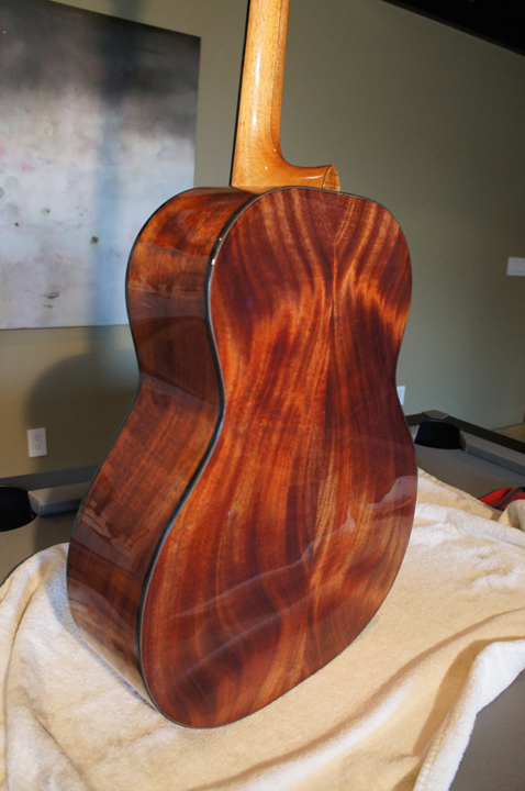

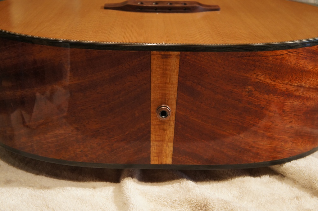

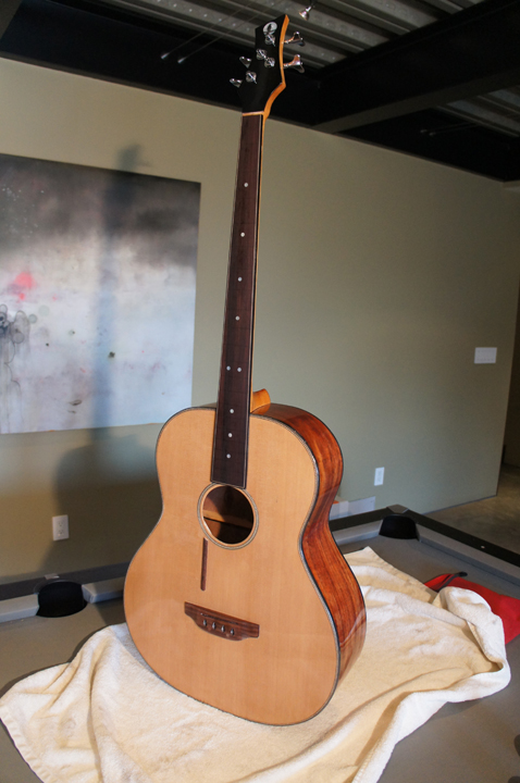

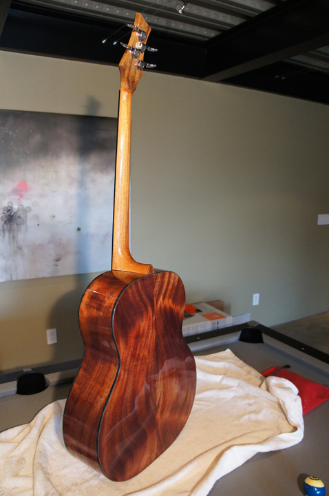

Re: Mark Stanley Bass Guitar polished, almost ready to strin
I polished out the guitar, I still need to make the nut and saddle and properly mount the tuning machines. But I could not help sending photos.
