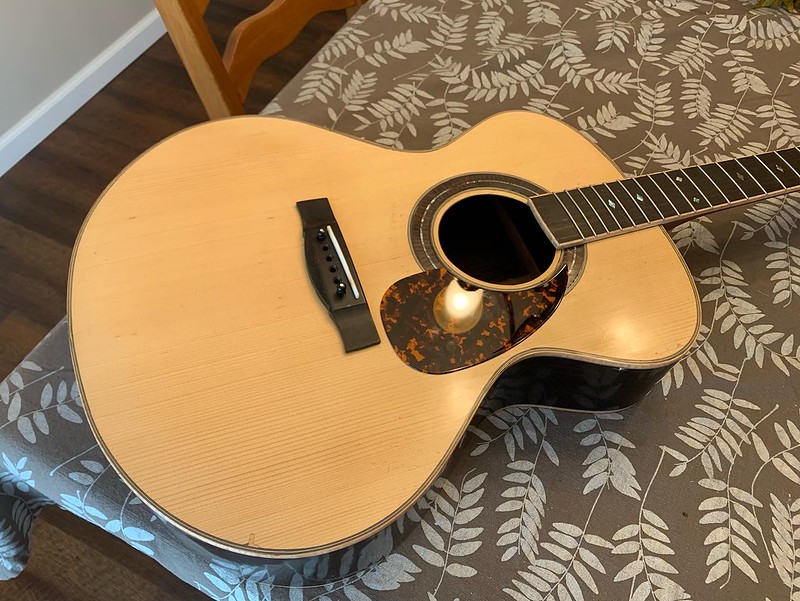

No this build is not finished, but it's about 98% there. I finished the French polish back in November but couldn't get Flickr to host the images.
Here's the top. I got the pickguard from Larrivee. I like the bevel and the thickness over what StewMac and LMI sells. It even covers a flaw in the rosette:
Here's the back. The pickguard inlay is meant simply to cover a mistake with jointing the purflings.
All that's really left to do is glue down the bridge, polish the neck and do the nut.
Posts: 4143
Re: 2nd scratch build - Carpathian over EIR
Looking good.
I like how you mirrored the heel cap with your fix on the back. Looks cool.
That pick guard is super nice.
Now getter done and start playin.

Part of the hold up was binding the headstock. The neck still needs to be polished as well. The tenon needs a shim too though the angle is good; it just has a little play.
Posts: 741
Joined: Sat Nov 13, 2010 9:55 pm
Location: Pittsburgh PA suburbs
Post by nkwak »
I've got it strung up and am in the process of doing the final setup. The neck is slightly underset so the action is on the high side, but it's a bolt on so I'm able to remove the bolts and stick some sandpaper on the sides on either side of the heel and move the heel up and down to alter the angle. There were also a few high frets but a;so I got them mostly level.
I'm using a preslotted nut though so it doesn't feel quite right. I need to tool up and learn to cut my own slots. I have some of the tools necessary to do a setup (action gauges, a 36in rule, a fret rocker, a crowning file, etc.) but not the nut slot files. Same with the bridge: I got it precompensated and it came high so it and the nut needed to be lowered. I've done that before though so it's not really a problem for me as the intonation is approaching where it should be now that I'm reducing the action. Having patience is my problem; with the finish line in sight I tend to rush.
Meanwhile, it's always something on the aesthetic side. Somehow some lines of purfling blew out in a couple of places during the buffing. Ugh.
