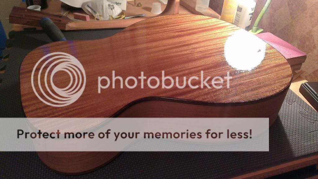

A coat of shellac (SealCoat) brings out the grain fairly well. The Damar set the grain off better, but was darker and more yellow. My Damar wasn't the freshest and my wife had put in the garage over last summer so I'm unsure if this affected it......but it dried really slow so picked up thumb prints etc. for a week or two after application. So I had no choice but to sand it off. I chose to go with SealCoat (shellac) as I didn't want to wait weeks for the Damar to cure. If I used a different solvent (wanted to test Mineral Spirits but haven't got around to it) the Damar might cure considerably faster. Also, if the Damar were more fresh or hadn't been left in the garage over a hot summer it might do better as well.
Here is a shot:
Here is a shot:
