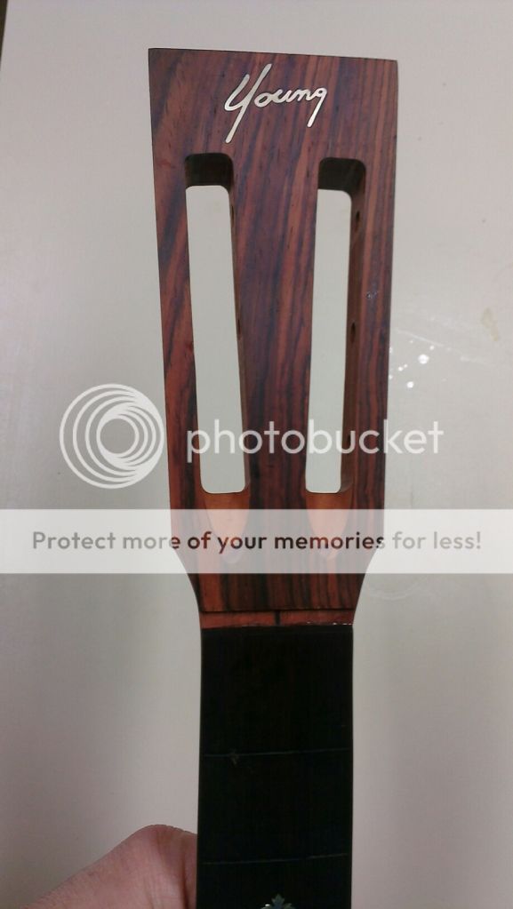

This is the first time I've built a slot head. I'll admit I was a little intimidated to cut the ramps at the bottom of the slots for string clearance. I was afraid I might mess up the slots and they look pretty good now. It was time to give it a try, good or bad. Turns out it wasn't as difficult as I had anticipated.
I used a 3/8" rasp from Home Depot to remove most of the material. There was a little clearance between the sides of the rasp and the sides of the slot so it was easy to keep centered. I followed that up with 220g wrapped around a 7/16" dowel. That was still a bit undersized so I used 2 layers (0.480") of 220g sandpaper and it came out fine.
A question, do the strings wrap over the horizontal shaft or do they angle underneath the shaft ( from the nut)? I assume the strings run from the nut then go over the horizontal shaft of the tuner.
Here is a picture:
Here is a picture:
