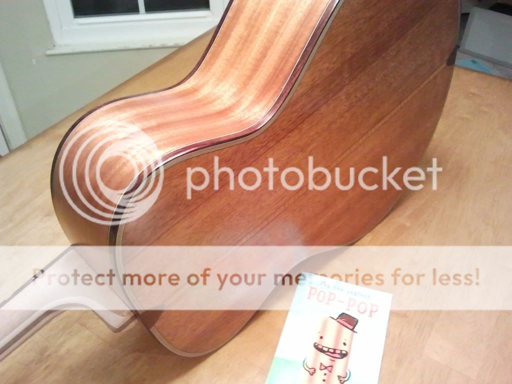

I still have some slight imperfections that I need to fill with CA glue so I sealed the body with 1 pound cut of ultra blonde shellac. This shows what the final tint of the woods will be:
Re: #1 in progress: cedar/mahogany medium jumbo scratch buil
The guitar is going to look great!
Yeah, looking pretty good.
Posts: 4076
That is very attractive wood Neil and you are making it all work out great.
Its going to be beeeeutiful under with the finish on it.

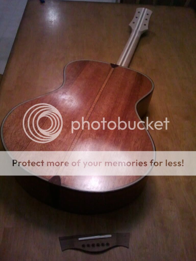

Thanks! I've been sweating getting everything level but looking at the pics all I can see is where the rosette tore out during routing and where the router bit in a little too much when I was doing the purfling trench and then how the purfling doesn't match up at either end...yeesh! I'm going to try to fill in what I can with CA and sawdust then maybe make a couple of decorative rosewood inserts where the purfling doesn't line up and try and inlay them.
FWIW the top rings wonderfully. Not too long but it's got a strong tap tone. It all hinges on the bridge though.

I've been trying to come up with an idea on how to fill in torn out purfling. Previous attempts at splicing in multiline purfling hasn't been successful so I opted to do some decorative inlay. I traced a guitar pick on some rosewood scrap and bound them with fine BWB purfling.
Neil the inlay looks great. Good solution.
