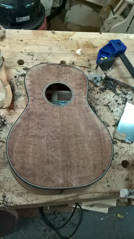

I usually do not use CA to glue in the bindings but have seen a bunch of builds where people do. So I went ahead and used thin CA. Before I did any gluing I did the best I could with tape to get the bindings fitting the way I wanted them. Then I only put a small amount of CA in between the tape. I worked slowly making sure that each place I glued was in its proper position. There were a few areas where I used clamps to get the bindings in. I clamped before gluing. When the glue cured I removed the tape and ran more CA along the bindings.
I decided to add a figured back strap to the head stock.
From Luthiers Supplies I bought a bunch of neck profile tools including a handy one for a tenor ukulele. I used the shape at the nut and the 10th fret to figure out good facets to cut. I used a spoke shave where I could and a rasp in the tight areas to cut the facet. Not shown but I drew out some secondary facets and cut those. From there I just used the template to guide my carving.
