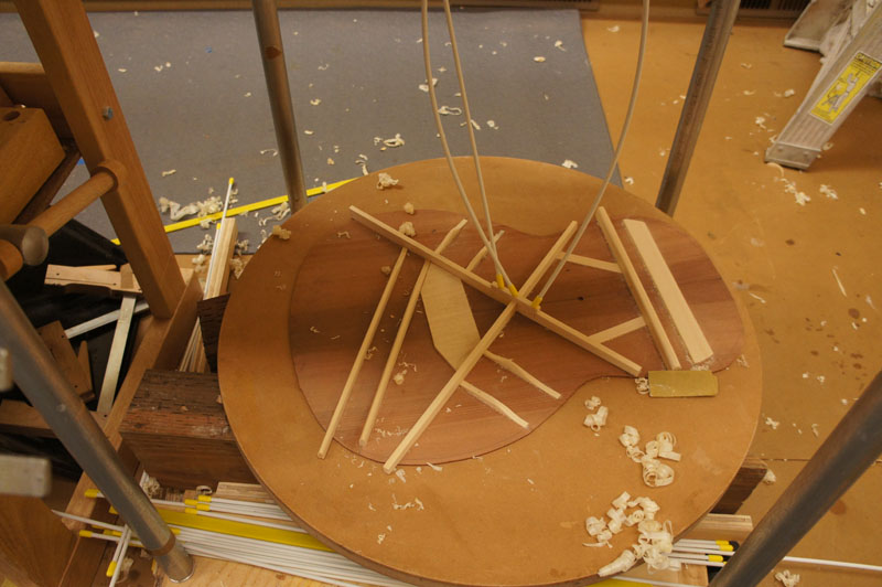

On to the top! I roughed out all of the braces. I cut them close on the band saw and either plane them or use the drum sander to take them to the correct width. I am changing the bracing pattern slightly from the plans for the 00 that I have. Those plans have two 1/4" wide upper transverse braces. Having two tall braces seemed like a pain with a bolt on neck and the truss rod adjustments. So I switched to one slightly thicker transverse braces moved lower toward the sound hole a bit and a popsicle brace. This is more like the 0 sized and the D14 sized guitars I have built.
I have a few pictures of making the x-brace. This had been hit or miss for me. Now I use an angle tool to mark out the lines I want to cut. I place the braces together in my parrot vise so that only the depth I want cut is above the vise head. After cutting nice but angled lines going down, I take the time to use a square to make sure I am cutting square. Otherwise the braces are tilted.
Now I am just waiting for the braces and the maple bridge patch to set.
