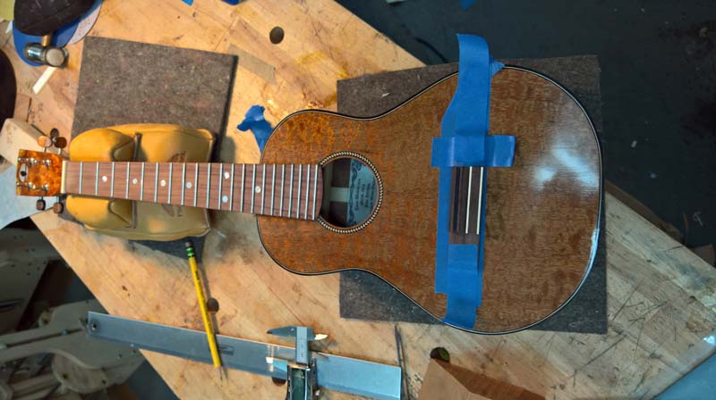

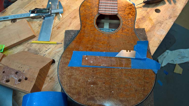

I did things a little different in an attempt to protect the finish a bit more than I usually do. I used blue tape around the bridge area while I set the bridge and cleared the bridge area of finish.

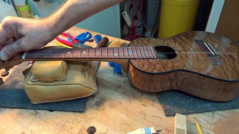

After locating the bridge and drilling some 1/16" locating pins, Double and triple checked the location using both a ruler and a neck template to assure that the bridge was placed correctly. I had to pull a bridge on a ukulele just once before and I want to keep it that way. A new thing that I always do is to check the string run. I can scope how the string follows the fret board on both sides, assuring me that the bridge is centered to the neck.

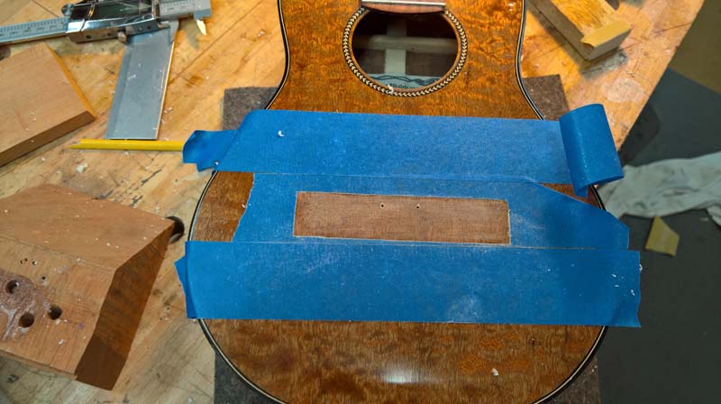

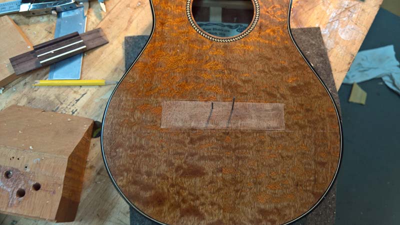

I used a scalpel and traced the located bridge cutting both through the tape and scoring the finish. I use a light touch and a very sharp blade. I do not want to slice into the wood. This gave me an area to clear protected by the remaining tape. I cleared the bridge area with a utility blade. I always tape off one end so I do not need to worry about the back point.
I only clear close while the tape is there. For the most part as I scrape close to the tape the finish breaks off at the score line. Once mostly clear, I remove the tape sand clean up right to the score line.

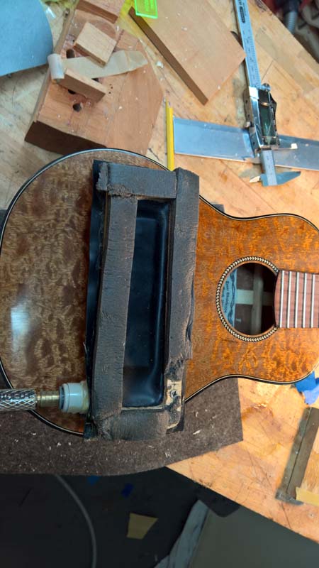

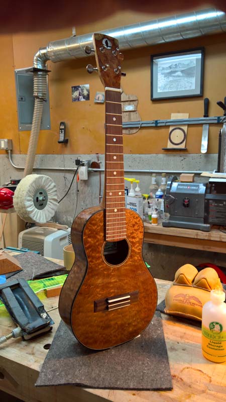

When I went to setup to use my very home made looking ukulele vacuum clamp I had to scratch my head as the clamp was too tall to effectively clamp the bridge.

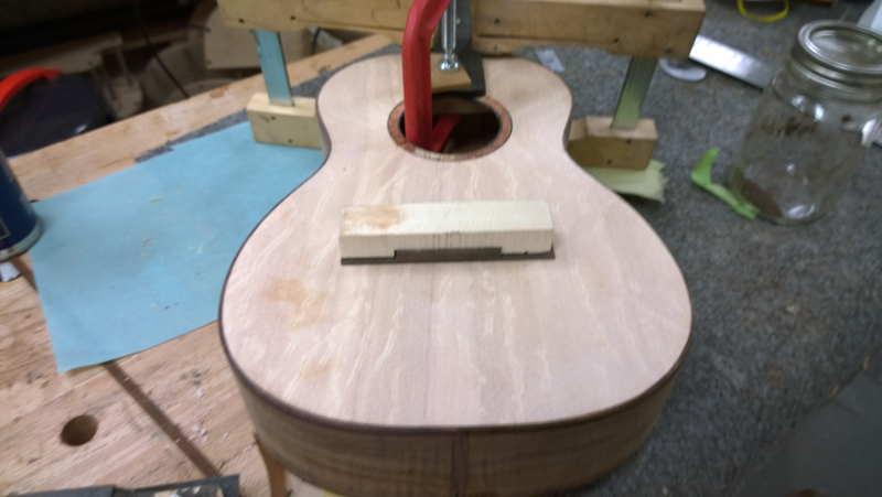

After a bit, I looked up a previous build and found this picture.
I found the caul right next to where I had the vacuum clamp. With it the vacuum clamp did its magic.
