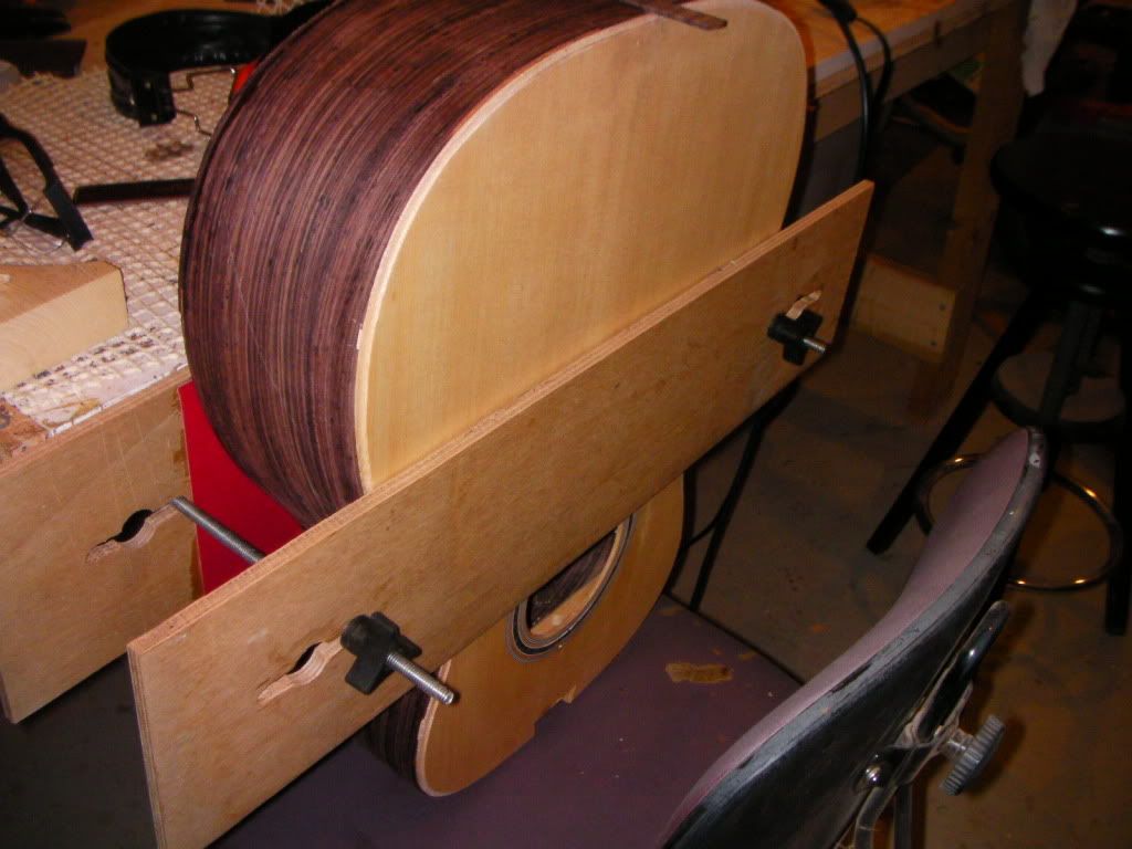

Bruce Dow
Re: guitar vise
Post by Bruce Dow »
Great thread!
In my "poor man's version", the "sling" to prevent drop-thru is a chair that I slide under while I'm adjusting.
I use a threaded rod with a keyhole set-up for quick engagement and then tightening. The main cross members are thin plywood, so that they flex to the contour of the guitar.
