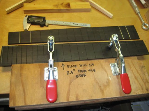

it's just 2 pieces of plywood. and underneath, there is a strip that fits exactly into the miter slot on my table saw.

This is what I use (from Rocker's website):
I have had mine for years, long before I ever starting building guitars. I simply draw lines on my f/b where I want to cut, run one edge of the f/b over my jointer to give me a good straight edge, put the straight edge of the f/b against the taper jig similar to the picture shown above, then set the taper jig such the distance from the fence to my line I want to cut is the same all the way down the fence. Once the taper jig is close, I'll set the fence so I cut a bit less than I need, run the f/b through the saw and check that my cut is parallel to my drawn line. If it isn't, I'll tweak the taper. If the line is parallel, I set the fence so my saw cuts along the long the line and run it through the saw. I then repeat for the other side. Takes about 10 to 15 minutes, and is adjustable to any taper.
