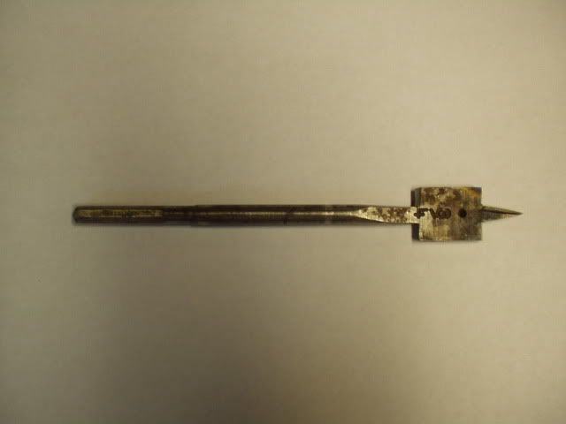

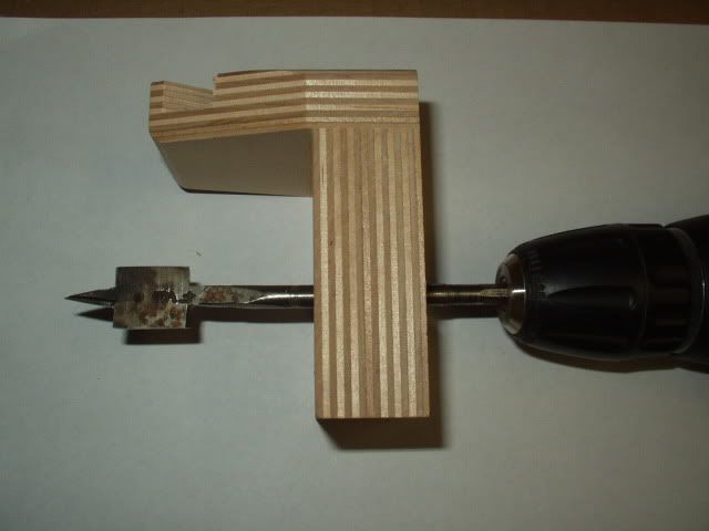

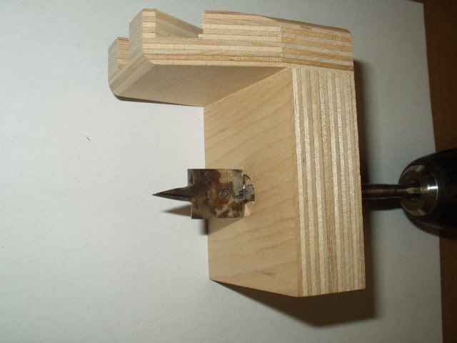

Thank you Ken!
That's my neck block & that should work.
Does anyone know what's up with these OEM Martin neck blocks? I'd think such a modification would not be needed.
Kevin Looker

I went ahead & lengthened the slot & increased the size of the countersink on the inside. Thanks again to Ken for spade bit idea.
