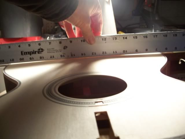

No pics but I chiseled the finger braces down to 1/4" in height and am in the process of reducing the height on the two side sound hole grafts down to the same.
As for the neck block rotation, the plans I'm following employ a neck block extension instead of a popsicle brace. I made mine out of birch plywood and thicker than the plans called for, mostly so that I could rout a channel for the truss rod access:

Re: Finally starting to brace my first build
Martin has been doing that since 1985 and it won't stop the rotaion , all that it will do is make the cave in more pronounced at the extension. I tried that very thing in the early 90's and stopped as that pulled the top down and cracked the top.
It may be best to allow for some deflection in the top . The traverse brace will carry most of that load and in a less concentrated area .
