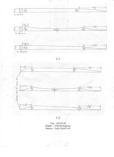

BTW, how does the bracing look? The dips in the X brace go down to 3/8" and the dips in the tone bars go down to 1/4". I'm also lowering the height on the finger braces and sound hole grafts but not by much - just so that I can get a .

Here's the Don Teeter measurements from a vintage Martin, the low point in the scallop is 21/64". I really think you need to loose those enormous finger braces -- their purpose is merely to prevent cracks, some builders only use one. Yours are adding a lot of unecessary weight -- not good. 1/4" x 1/4" does the job just fine.
Re: Finally starting to brace my first build
And in my view/opinion there is no need for such heavy bracing around the sound hole, again those are just there to prevent splits. Old guitars cave in at the sound hole mainly due to humidity problems -- so even those thick braces will not prevent that in the long term -- only balanced moisture content over the life of the guitar will help prevent that problem from occurring.
The sound hole dips as the neck block rotates and the torque of the bridge. Here I have to agree with Rick Davis , I do agree that the finger braces are anti split and don't need to be as large as what is pictured. Martin uses a 1/4 in brace here .
