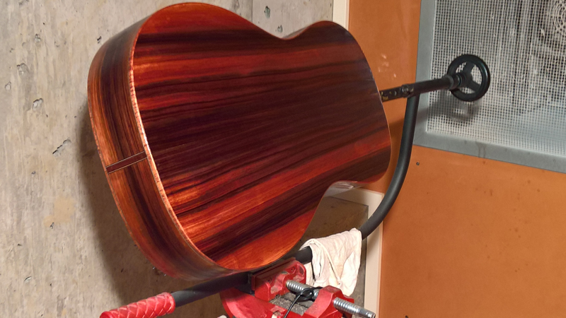

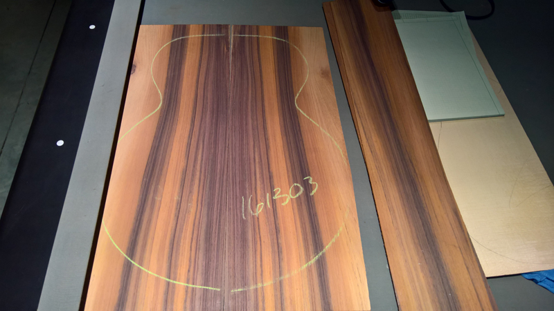

I have not been blogging this as it does not have any new techniques in it. Unlike many of my previous builds this has pretty standard x-bracing. I have Kent Everett voicing a Steel String Guitar and I have been trying to follow his method of voicing the guitar. I will be interested to hear how it turns out. The top does have a good tap tone now and to my feel has the right amount of flexibility. We shall see.
This is the first time I have used Indonesian Rosewood. It is the same species as East Indian Rosewood just grown in a different environment. It seems and works just like EIR. I will bind the guitar with Australian Black wood with a BWB side purfling. I also used it for an end graph, instead of a wedge. More classical like trim. Here is where I am now with a few construction photos thrown in.

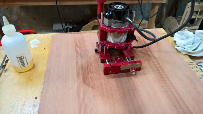

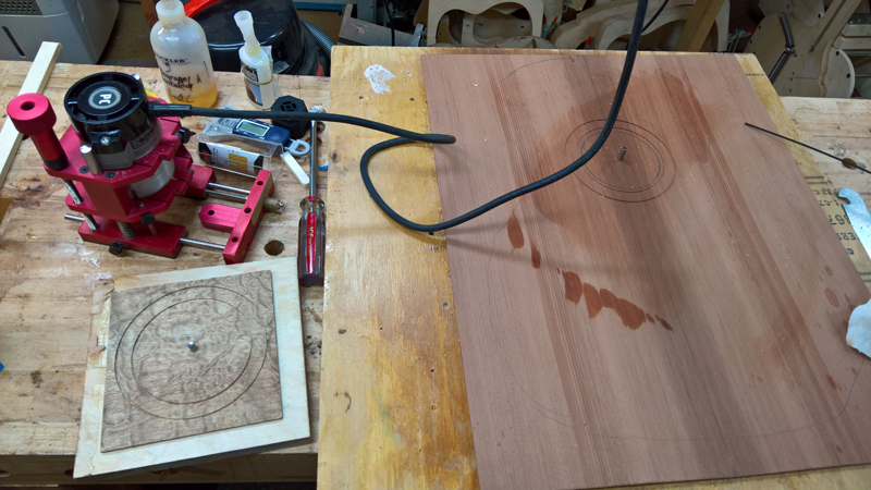

I used a 3/32' end mill to route the rebate for the rosette. It is just the right size to pack in 2 bwb prufling strips. Using the same router setting for top and the rosette assured that I had the right width rebate a rosette ring for my final rosette.

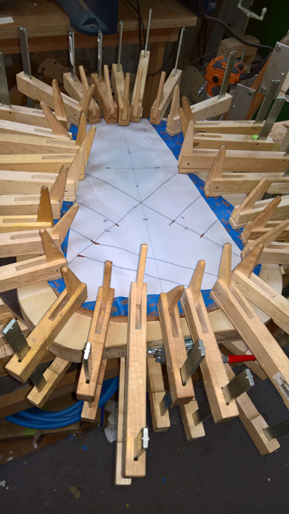

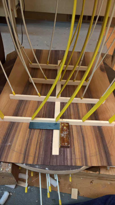

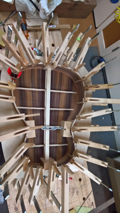

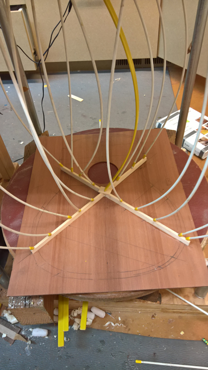

Did all of the brace glue ups in my go bar deck not bothering with the vacuum box I have.

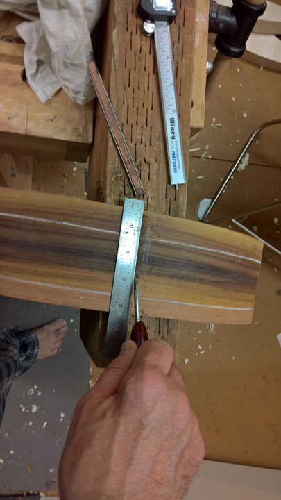

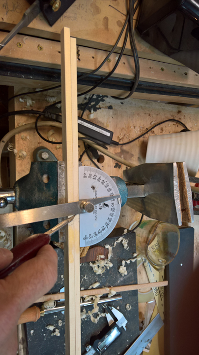

Marking and cutting the notch for the x brace. The joint was very tight and for once straight.

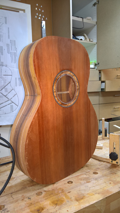

I put some shellac on the redwood to protect it. I am also working with a 5 mill mylar template tape to the top. Here is a picture before I covered the top

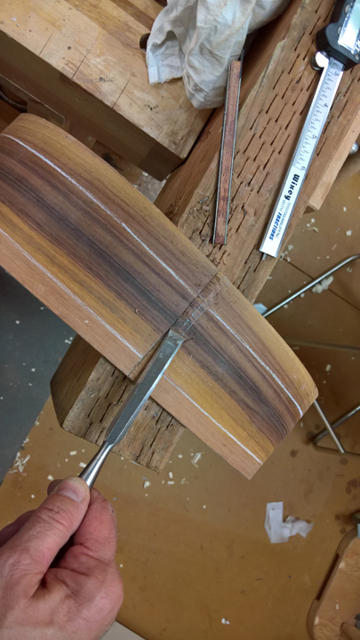

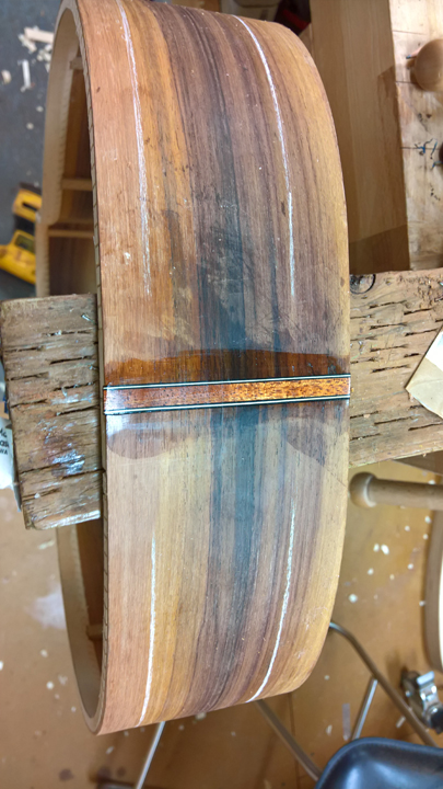

Cut the channel for the end graph with a scalpel and a chisel.

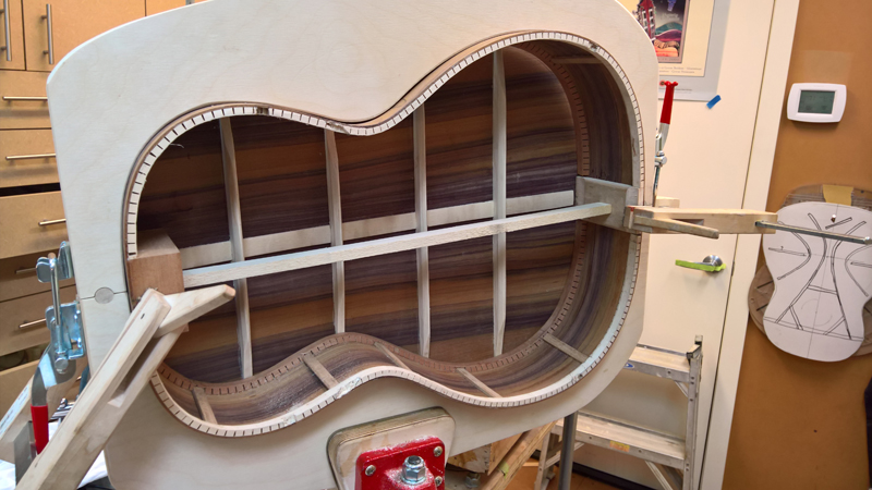

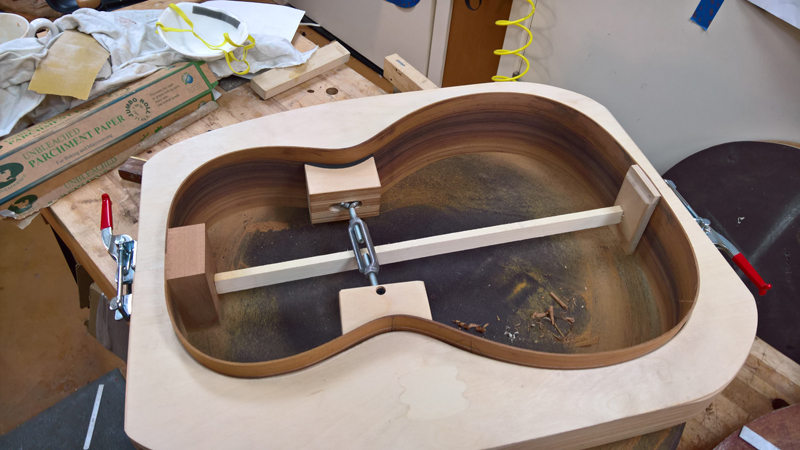

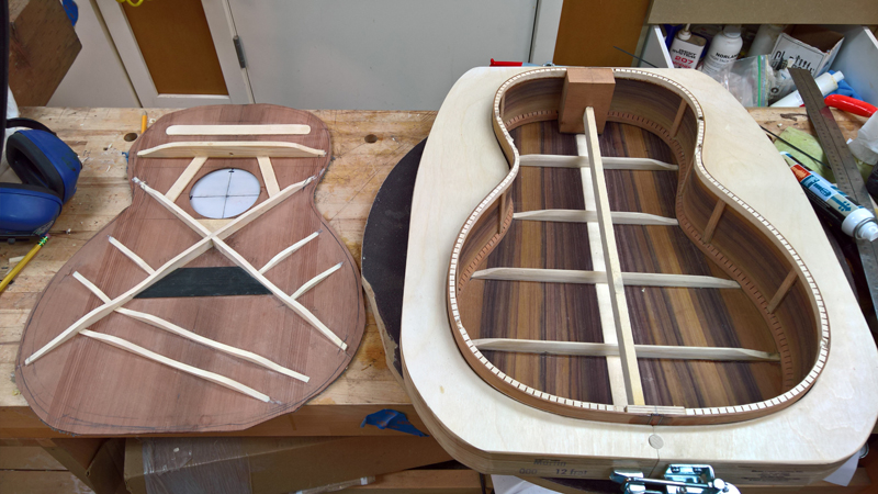

I marked out and cut the notches in the linings for the top and back and am in the process of cleaning everything up before I close the box

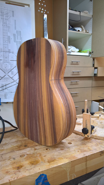

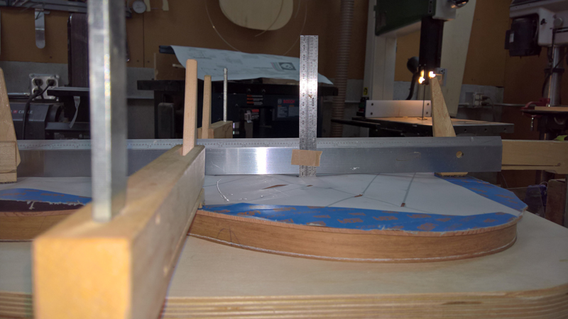

I just closed the box. This is the first guitar (other than an acoustic bass) I built using a 40' radius dish for the top instead of a 28' or 30' radius. When I have used a 28' or 30' radius I would always have to somewhat flatten the angle of the upper bout (mostly removing wood around the waist with a flat sanding bar). With the 40' radius I was right on. Given that the rims kept the 40' radius profile and all the braces except the center of the transverse brace were radiused to 40' the top fit like a glove (not OJ's).
My target is 2.5 mm from the plain of the neck to the top at the saddle.

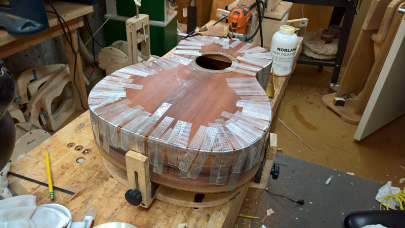

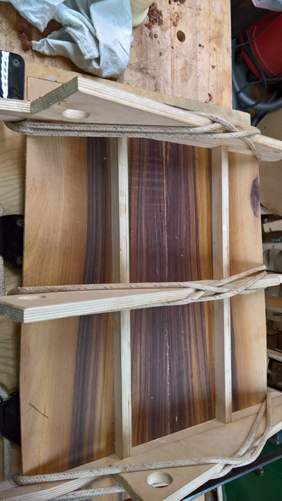

Top on before gluing, when I did glue it on I started getting a bit of squeeze out just from the weight of the top.

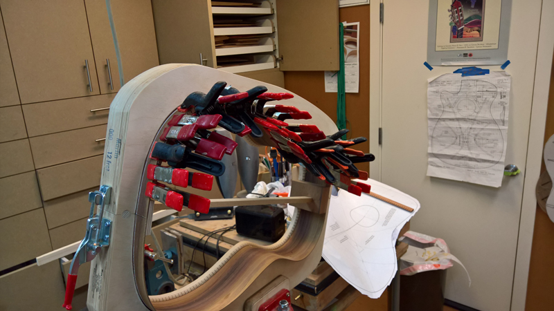

Still a bunch of clamps were involved

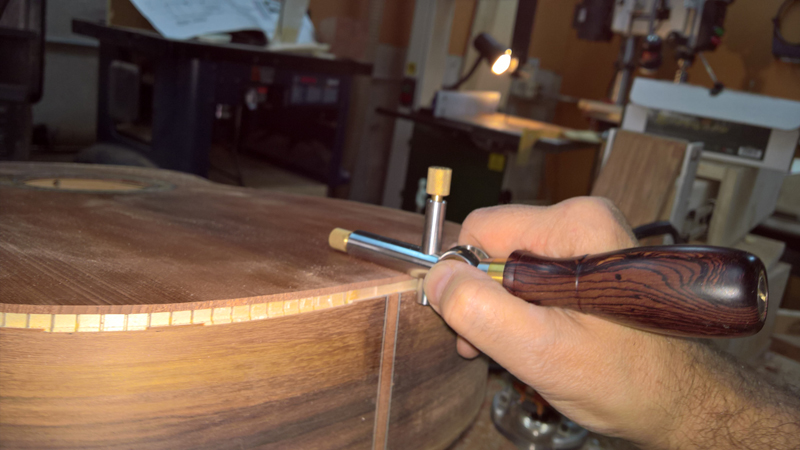

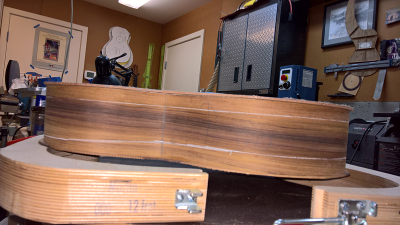

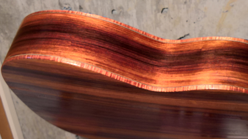

I bent a set of Australian Blackwood bindings with a BWB prufling and leveled the the sides getting ready to bind the machine.
I was planning to do some fancy mitering when I routed the for the bindings I lifted over the endgraph a bit by gluing on a stripe of purfling to the top. Then I finished cutting the binding rebate by the end graph by hand.
But in a loss of focus, when I noticed part of the rebate was not cut cleanly I ran the router clear around the guitar so now I am set up for a clean butt joint between the bindings and the end graph. I am OK with that. A clean butt joint looks better than a bad miter. In any case I glued in the bindings with an additional black fiber strip on the top.

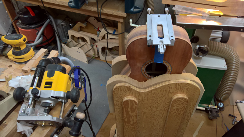

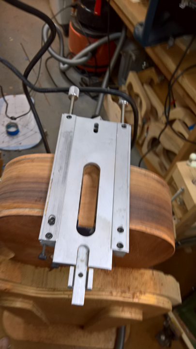

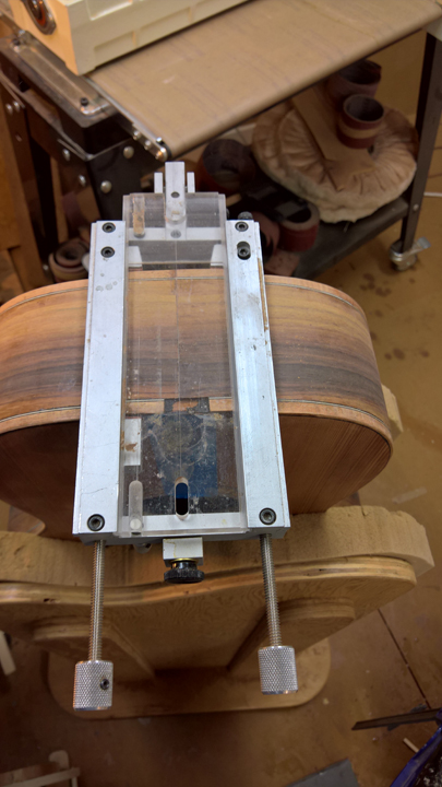

With the binding glued on I routed the mortise in the top of the guitar using the jig I have from Luthier tools. I had no problems or excitement and ended with a clean centered mortise.

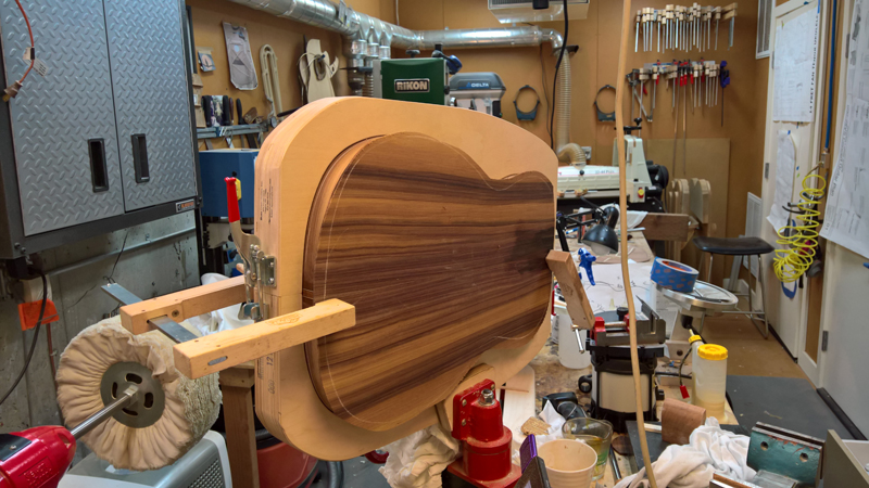

I had been doing finish prep for the last few days, so I drilled for the neck bolt so that I could put the guitar into my finish jig and applied the first coat of zpoxy. I am really liking how it looks on this wood combo.

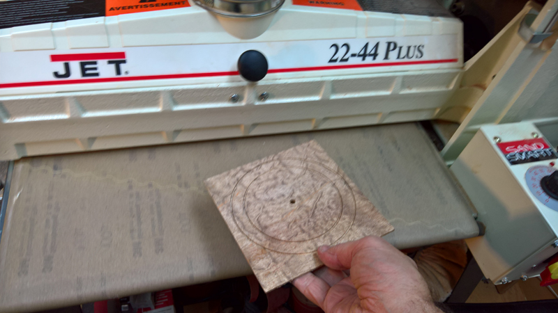

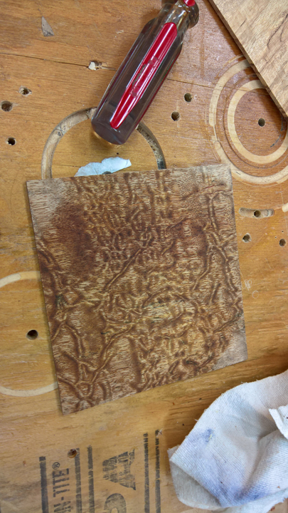

I had a template for the head stock so I used it to trim a 2 mm thick slice of amboyna burl (the red will match the top)
