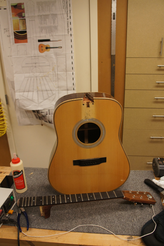

I have a nephew that wants a guitar, and I thought of this guitar, but properly put together. So I watched John's video and pulled the neck. I did have a stew mac jig which made my life easier. It only took a couple of minutes of steam and the neck popped out.

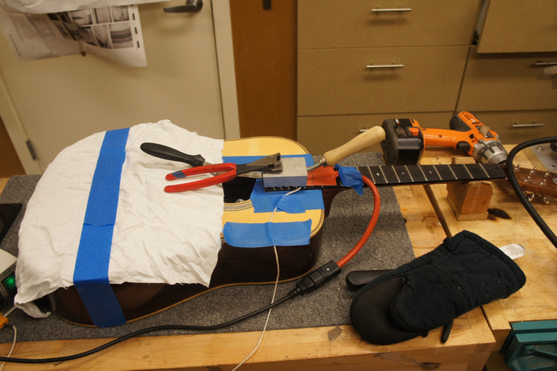

I pulled the 14th fret and drilled a couple of holes, luckily it is ebony and easy to clean up.

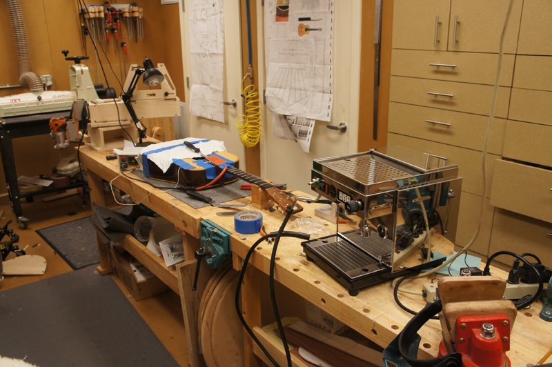

You can see I am all setup up with an old espresso machine and the heat blanket. I heated the iron in an oven as well, mostly I used the iron to hod the pad down, but I did not want it stealing heat. For my repair blankets I have a LMI controller that lets me set the temperature. I set it to 250 degrees and waited about 5 minutes.

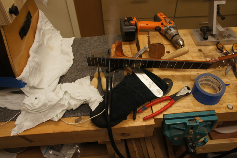

One trick I learned from the John Hall video was to use one knife to start to free the fret board and then slide another smaller knife over the top of the first. It really helps avoid sliding the pastry knifes in through the spruce tops.

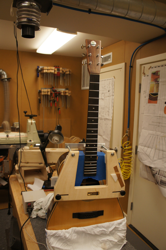

I have no pictures steaming but you can see the guitar in the stewmac clamp applying just a little bit of stress on the glue joint. Followed by the popped neck with the steam needle I got from Stewmac still in the fret board making steam.
I am very happy with the neck off and no harm to the KTM-SV finish.
