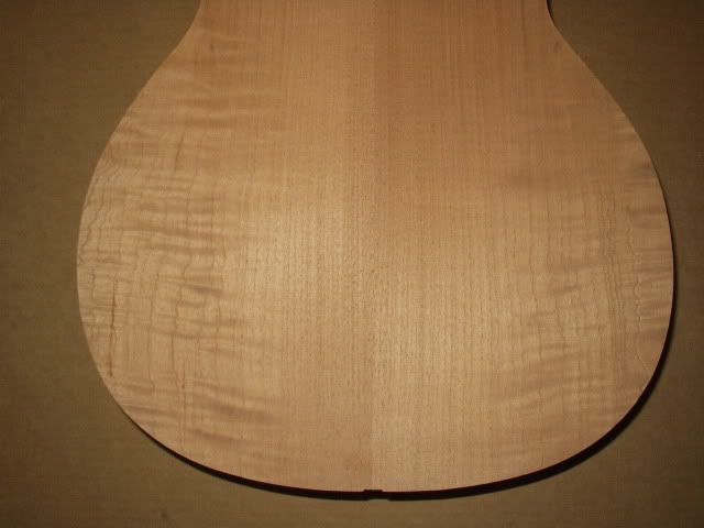

My brother asked me to build him a guitar. I had him pick out a back and side set and a top from RC Tonewoods. He picked the sinker redwood (on special :)) and quilted spanish cedar for the back and sides. I have seen flamenco guitars build with Spanish cedar but not a steel string. The wood looks really nice and supposedly it is hard enough. We shall see. I have not picked out the bindings, but I will go with something dark. Also I am using zipflex pearl for the purflings and maybe as part of the rosette. The wood in the pictures are from the rc tonewoods website of close to the wood I bought. Quilted spanish cedar:
Sinker Redwood.

I like that striped sinker, should look awesome under finish!
Re: Starting a new steel sting o size guitar for my brother.
Spanish Cedar is nice to work -- take care bending the sides even perfect 1/4 sawn will tend to de-laminate. I picked a super board suitable for guitars at the local Woodcraft store. Steel string no problem -- here's an OM in process -- pinless bridge too. This instrument is light as a feather! So my point is -- SC is a great choice for a SS guitar -- I got the idea when I saw a Spanish Cedar special editon Martin OM!
