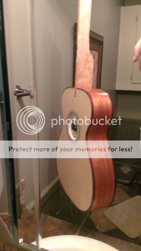

I sure don't feel I've done a good job on the finish. I ran out of finish 1 coat shy of my goal. I'm wishing I hadn't used so much product for testing. Also, I sprayed a bit heavy in the slots of the slotted headstock and the finish ran out onto the headstock. After the compressor quit I got in too big a hurry and sprayed heavy enough I got a sag on top and a couple on the back. Anyone want to send your guitar to me to finish??? <smile>
Here is a shot of the guitar hanging in the spare half bath after spraying:

Hey Darryl,
are you shooting in the garage and bringing it inside to dry? what are your temps down there right now?
Re: Cuban Mahogany and Lutz Spruce 00
I sprayed outside and brought the gun inside between sessions.......also hung the body/neck inside to dry between sessions.
After my compressor cut out I got in rush and did a poor job on that coat unfortunately. I have a sag on the back and the top and the sag around the slots on the headstock. I tried scraping off the most prominent protions and shipped out an area on the back. On the top, I sanded through in an adjacent area before I completely leveled the sag. This was probably because I didn't have enough finish and only had about 0.002" of finish on the guitar.
So long story short, I will sand down and respray the body. I might be able to salvage the finish on the neck, still debating. I think it will look fine, just worried about the durability of a thin finish on the neck.
Sanding the neck down as well......bummer. Man this is fun!!! <smile>
