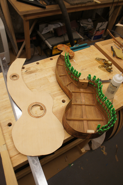

One step forward a few steps back. I was doing the final sanding of the top; getting ready to spray … when I sanded the treble side of the upper bout too thin not paying attention while trying to fix a flaw. I started a repair and was making good progress, involved cutting a prufling channel out to pick-up another area near the peghead that was not great, when I stopped and reassessed the situation. This can be a really nice instrument. I am in no hurry to finish and nobody is waiting for it. So...
I decided I was going to put a new top on with new bindings.
I pulled out my heat gun; popped the bindings off, also used heat to take the top off. I cleaned the body and I have some reverse kerfling setting into shape. Interesting with the reverse kerfling I need to expand the kerfs in the waist area to allow it to bend enough.

Starting on the new top. wish me luck

It's a hard situation to be looking at a completed body and feel like you have to tear into it again, but it sounds like you made the right choice there.

I think I made the right decision. I am in it for the building so I might as well make it right. Plus I got to try a bunch of skills. I am putting it back together. Luckily I had the next slice of amboyna, so I was able to make two new rosettes. No CA this time I used white glue for the top, it was a bit loose as I had to use the dremel, and duco for the main rosette.
I am putting the kerfling on a tad high to sand level at the right hight for the alreay cut channels.

Dennis, Thanks for the encouragement. I think I am back on track, I have every thing back together again, except for the bindings. I have the channels cut and ready for the binding. After my last attempt, this time my binding channels are perfect, just where I want them. I did figure out why I messed up my last set, followed by my poor attempt to hide the error. I use a stewmac tower jig. It works OK as long as you have the correct bearing except the last time I used it. There is a little screw that holds the plastic donut on to the router carriage. This came loose on mine, and there was something holding the donut skewed through the time I set the height and tested it. While doing the routing the shaking and gravity tighted the donut to the carriage resulting in a deeper cut than I wanted. I found this out today, because it happend again! but on my second test pass. Finally up is not down, red is not blue there is reason in the world I understand why the channel height changed the last time.
So now with a top of the corrrect thickness, glued to the body and the binding channel cut and ready, I should be ready to finish the construction the second time tomorrow. I am really happy I tore the top off and remade it. I learned how to retop an instrument and change the bindings keeping overal depth the same.
