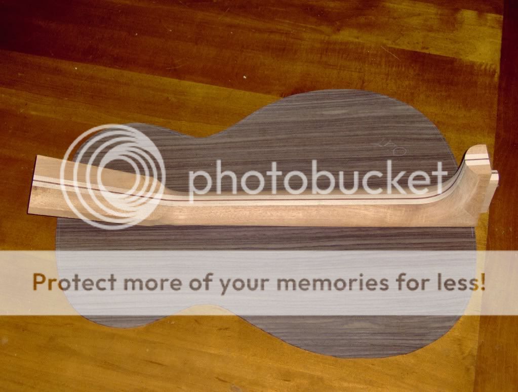

Here's the back and the 5 piece neck (mahogany, maple, bloodwood).
