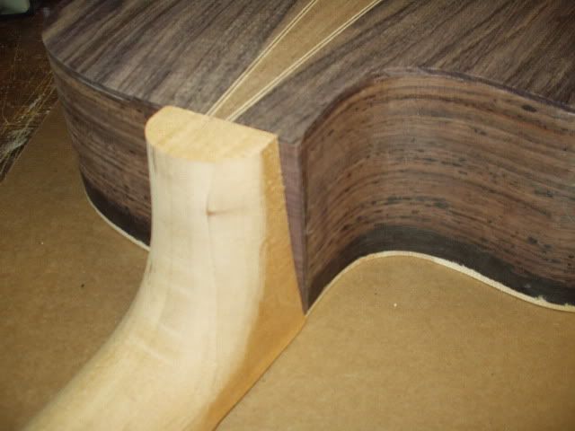

This has been in the planning stage for a long time --- I prefer NS so this one will be my personal every day player. It has a soundboard mounted dual pick up with end pin pre-amp. We now make the Gibson style rounded heel necks and these will be standard on all the cutaway models SS and NS. As usual there are plenty of builder options available. The 35 style three piece back is one of my favorites - Walnut and EIR was used here.

I prefer the Gibson style rounded heel also, and that is a neat looking bridge design too.
So how did you brace the top for this guitar. Is the top thin like a classical?
Feb 21, 10 | 4:43 pm

It has a fairly standard Torres fan brace pattern -- no hocus pocus -- but I do tap and thin each top until I get a little flex across the grain -- so what I am saying is I don't have a standard thickness for any model. I believe anybody can hear the ring and sustain of a lively top once you know what to listen for (I know don't end a sentence like this). Too think it sounds like a table top too thin it sounds like a piece of cardboard. The top on this one is Sitka right around .090"
Thank you, I had a curvy bridge designed then this came to me --- seems to suit the instrument well.

I like it Ken, can't wait to see it finished. I too like the Gibson style heel for cutaways. I have seen the standard tapered Martin style, nothing wrong with it, but I like the cleanliness and continuity the gibson heel adds. Thats what I have going for my two OMs right now.
I bought a 12 string neck that was on discount from Hanalei moon....its the tapered standard Martin heel. Prblem is, I want to do a cutaway. I have two thoughts.....deal with the corner showing, or try to curve the side to mount flush to the taper. I am just curious what that will do to the strength of the neck joint for a 12.....I just really think I want a cutaway. Dilemmas! Anyway, good lookin guitar there.

It's all subjective -- but I am a huge fan of Black Walnut, I like the look, I like the sound (to me between EIR and Mahogany), and I like the way the shop smells when Walnut being machined.
One of Overholtser's award winning Classicals was made of Walnut -- There's more fine Walnut guitars out there then one might realize.
