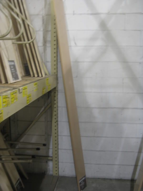

Here's the board before I had touched it. 8'x8"x1"

Dan, Is that Luan mahogany? What is often used for flooring?

I don't know, it just said Mahogany on it and it was cheap enough and worth experimenting with as far as sawing my own stuff, and doing my first scratch kit.
