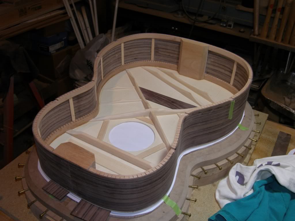

Figured it was about time to post some work-in-process (WIP) photo's for the 00-12 Fret model I am building. Ken (KMG) was able to massage a 000-12F drawing to come up with the basic shape and layout. Taking that information I was able to create a template, mold, and bending form. So far it has worked out pretty well. I'm in the process of final neck shaping, fitting, and adjusting. Hopefully I will start finishing in the next week. I'll post some more pictures as available. I believe that Ken will soon be offering a 00-12F Kit. As with the J-200 I recently built, I'm not sure why there's not more interest in the 00-12F. Lot's of history there!

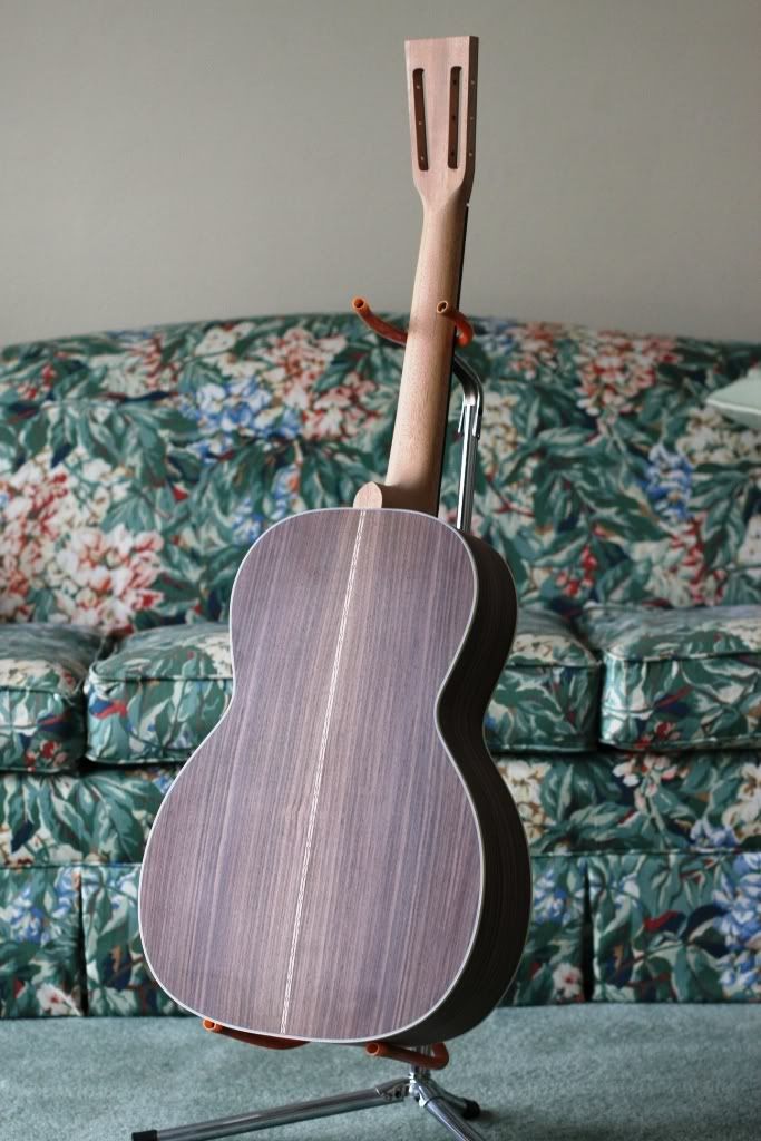

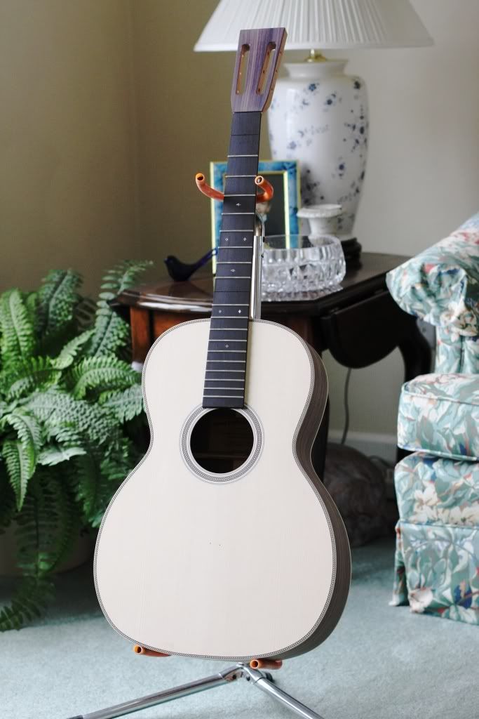

DaveH
Total Topics: 5
Total Posts: 20
I just completed the 00-12F. Other than dropping the body during finish, the build went fairly straight forward. I'd rather build than repair. The finish is Behlen's Instrument Lacquer with a few applications of McFadden Rosewood Pore filler. The Top is E-Spruce supplied by KMG-Ken. I choose not to apply a toner to the top. Even though the top is very white I like the contrast.
I included a picture of "Big Brother" & "Little Brother"
Mar 14, 10 | 3:39 pm

Hey Dave - I'll be getting another kit from KMG next week, also with the englemann top.
May I ask how you kept such a white top immaculately clean through the build process? It looks great, but other than taping a piece of posterboard or cardboard to the top, I don't have any other clues as to how to maintain that purity.
Anyone got ideas?

Dave B.,
No real special precautions other than the obvious. Prior to assembly I usually stack the top and back with support on the top and bottom (usually templates/patterns) & seperated with paper. After assembly I always put a towel or similar on my work bench. Don't forget that you will give the top a thorough sanding prior to finish, so you will be able to sand out light defects. I recommend that you sand the top last, as the spruce is much softer than the Rosewood (in this case).
Keep in mind that the pictures don't show every "nook and cranny". While the top is pretty clean I do have some scratches in the E-Spruce. As mentioned in my recent updates, the body actually dropped during finishing. This unfortunately left some small scratches on the Soundboard. I really didn't notice them until I was rubbing out the lacquer.
I think you're idea of taping posterboard or cardboard to the top is good. I would put a soft cotton rag (or similar) between the cardboard and the top.
Mar 17, 10 | 12:50 pm
