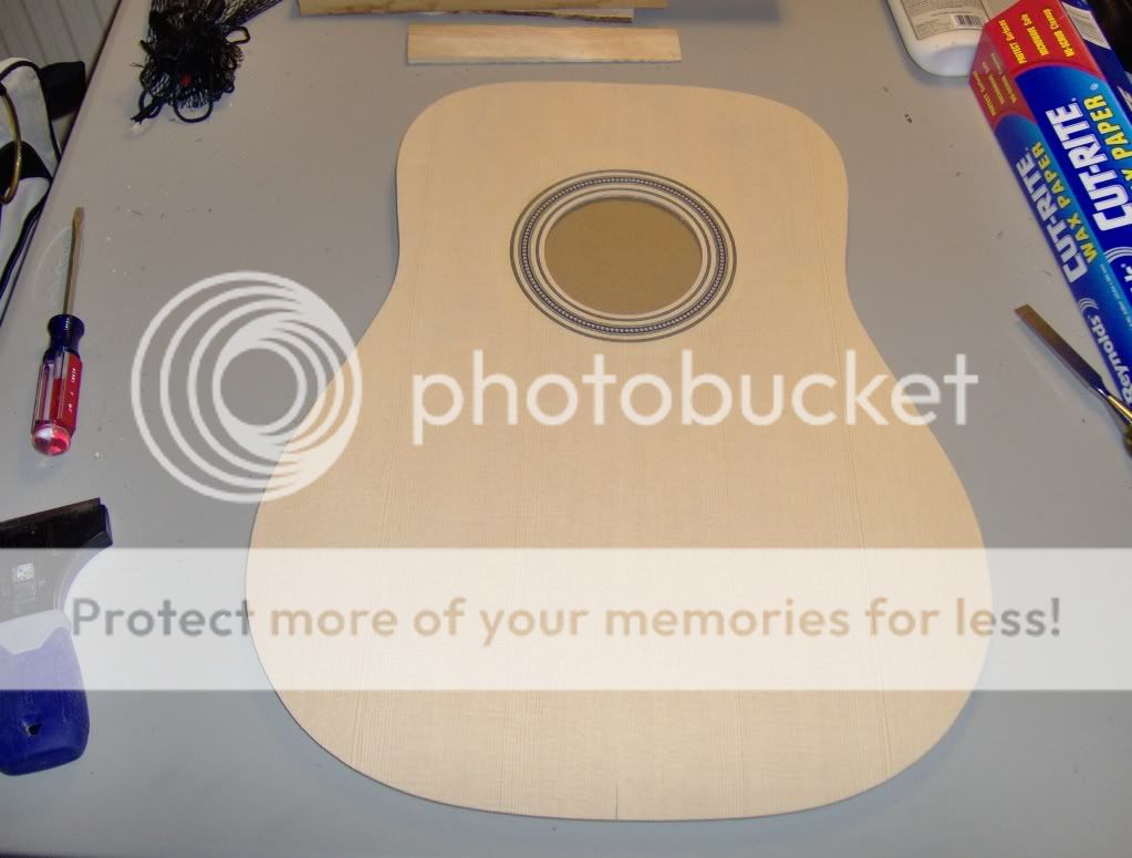

Here are some of the pieces:
First the Spruce top (not sure which variety, but it's a pretty top. The soundhole and rosette area are cut out. The purfling is herringbone with a black plastic binding top and bottom, and black plastic tail piece, which I may replace if I find something suitable

Got the rosette glued in, sanded down. Glad you won't be able to see the middle part where it was joined. The herringbone didn't match too well. I cut it ok, but the dimensions didn't allow it to match up. The outer ring was not long enough to join either.

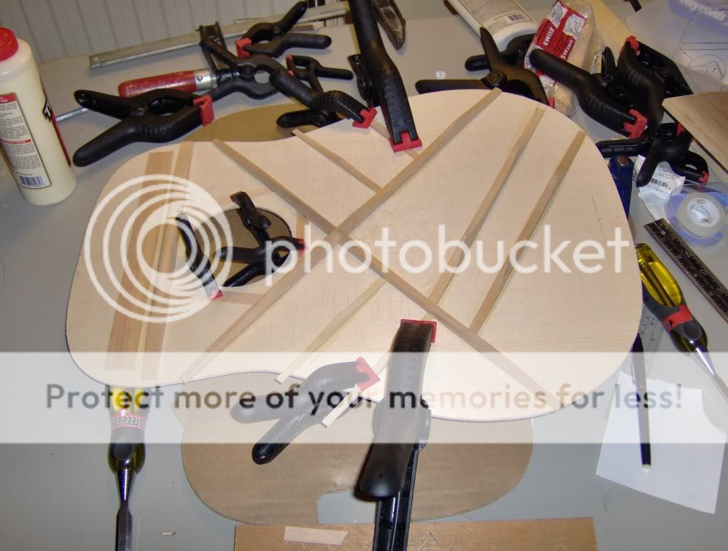

Here are the back and top after most of the bracing is done. I'm really happy with those little clamps I got at Lowe's. They worked well for this type of clamping. On the X-bracing, I had to put 2 long strips of wood and some shims along the length of the top in order to get the middle part of the braces to bottom out. I know a go-bar deck would have been better, but I've spent enough money already. That said, my problem now is the bridge plate and for the back, the 5 strips down the center. Any suggestions? I might have some bricks around.
Also, I'm getting very concerned about binding. I just emailed Ken Cierp about his binding attachments, especially the one that uses straight cutting bits. This seems the cheaper way to go, but is it good enough? If I cut too many corners, I'll end up going in circles, and that's more wasteful. Suggestions here? I definitely cannot afford those big pro-type attachments.

Finished up the top and back bracing today.
The only thing waiting on the top was the bridge plate. The first picture shows my "East Texas Go-Bar".
The 2nd and 3rd are just the completed top and back.
